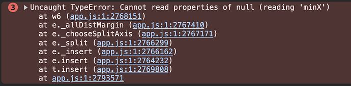

Still an issue in the latest insider version of Obsidian. In my main vault I’m seeing the following error in the developer console when moving the groups, though it doesn’t show these errors in the sandbox vault for some reason (though the issue is still present in the sandbox vault)
