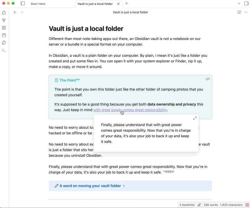

It doesn’t close the “first” tab, but does cmd/ctrl clicking on the book/pen icon get you part of the way there?
CleanShot 2025-07-31 at 21.12.29
That makes the process a bit faster indeed. Thank you for sharing that tip.
Any logical idea why that option to open in a right/bottom pane is not implemented?
Also, when I use that method with CMD, unlike the Split Right, my notes now have a link icon. What is that and why does it show when I use CMD, but not when I right click?
A cmd/ctrl click on the book/pen icon is the equivalent of 1) split right 2) link with tab 3) change the right tab group to Reading view (or to the editor) all in one.
Thanks for clarifying! :raising_hands:
I tried it and I see what what it does.

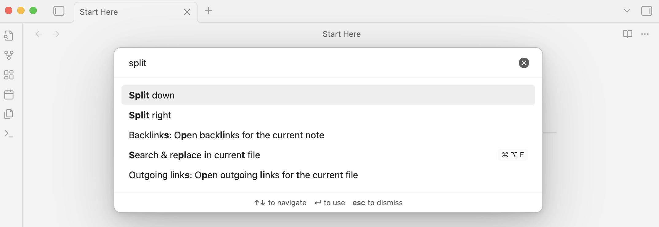

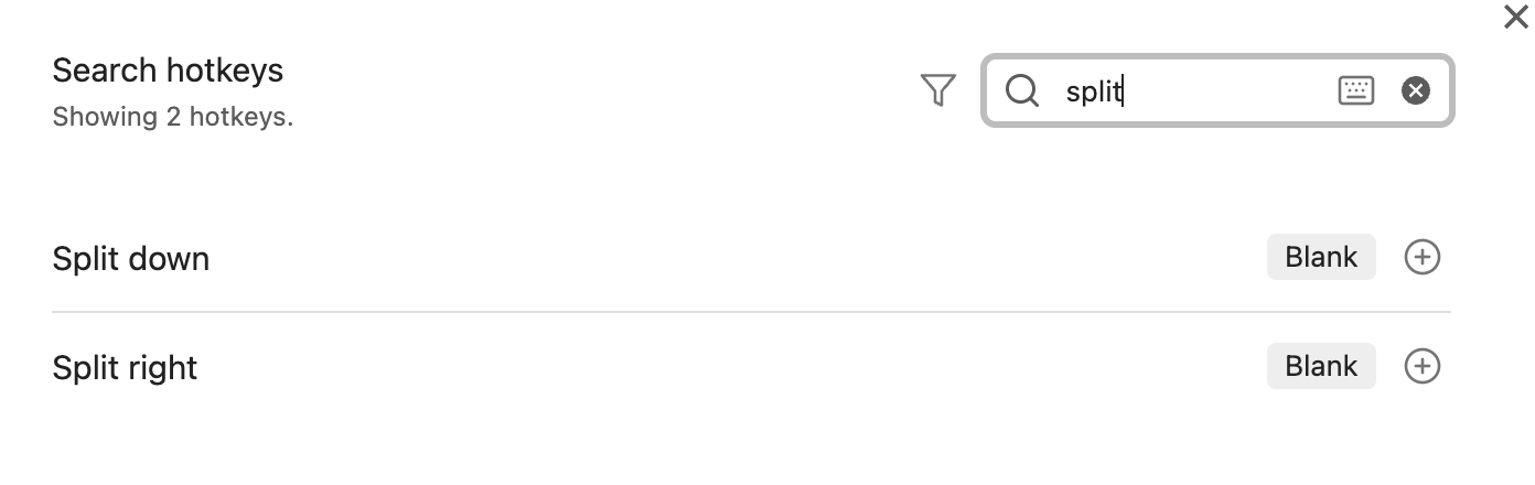

There are also Split down and Split right commands you can assign hotkey to.
The commands aren’t assigned hotkeys by default.
