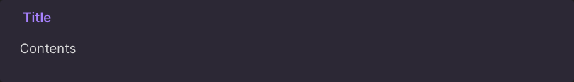

  1. Create a callout
> [!example] Title
> Contents
  1. Add customise the callout’s icon with a CSS snippet
.callout[data-callout="example"] {
  --callout-icon: arrow-up-a-z;
  1. Enable the snippet in the settings (Appearance > scroll to the bottom)
