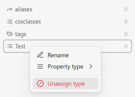

Did you check that the capital-letter versions no longer have property types assigned to them?
  1. Settings > Core plugins > enable Properties view
  2. Command palette (Ctrl+P or Cmd+P) > Properties view: Show all properties
  3. In the Properties view, if a capital-letter tag is still there and shows “0” instances, right click it and select Unasign type.
If all’s well, it should disappear from the list. If it remains, you might have to do renaming chicanery:
