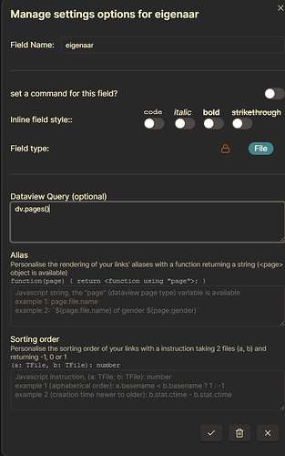

I’m using the Metadata Menu. I try to add a field/property of the type ‘file’.
I try to use the Dataview Query option, but I can’t get it to return all the files that match the filter I define.
Even if I only add dv.pages(), which should, I think, return all the markdown files in my vault, I don’t get all the markdown files.
If I leave the Dataview Query empty, it does return all the markdown files in my vault.
Not use a query at all: result => returns all markdown files in my vault, probably also the images, but I didn’t check that.
dv.pages(): result => returns some of my files in my vault, can’t figure out why only those and not others
`dv.pages().where(p => p.fileClass === “organisatie”): result => returns nothing
`dv.pages().where(p => p.file.name.startsWith(“+”): result => returns some of the files starting with +. Can’t figure out why some files are returned and some aren’t.
`dv.pages().where(p => p.databron === “remote”): result => returns some of the files of which the property ‘databron’ is equal to “remote”.

If someone else ever struggles with this. ‘Pch’ from Discord explained it to me.
Maybe you could try:
dv.pages().where(p => p.fileClass === “organisatie”).file.link
(Seemed to work in one of my test vaults )
The File type of input needs to be a link (if I understood correctly how it all works ) which is not what
… returns per Dataview’s documentation:
Return a data array of page objects, which are plain objects with all of the page fields as values.
