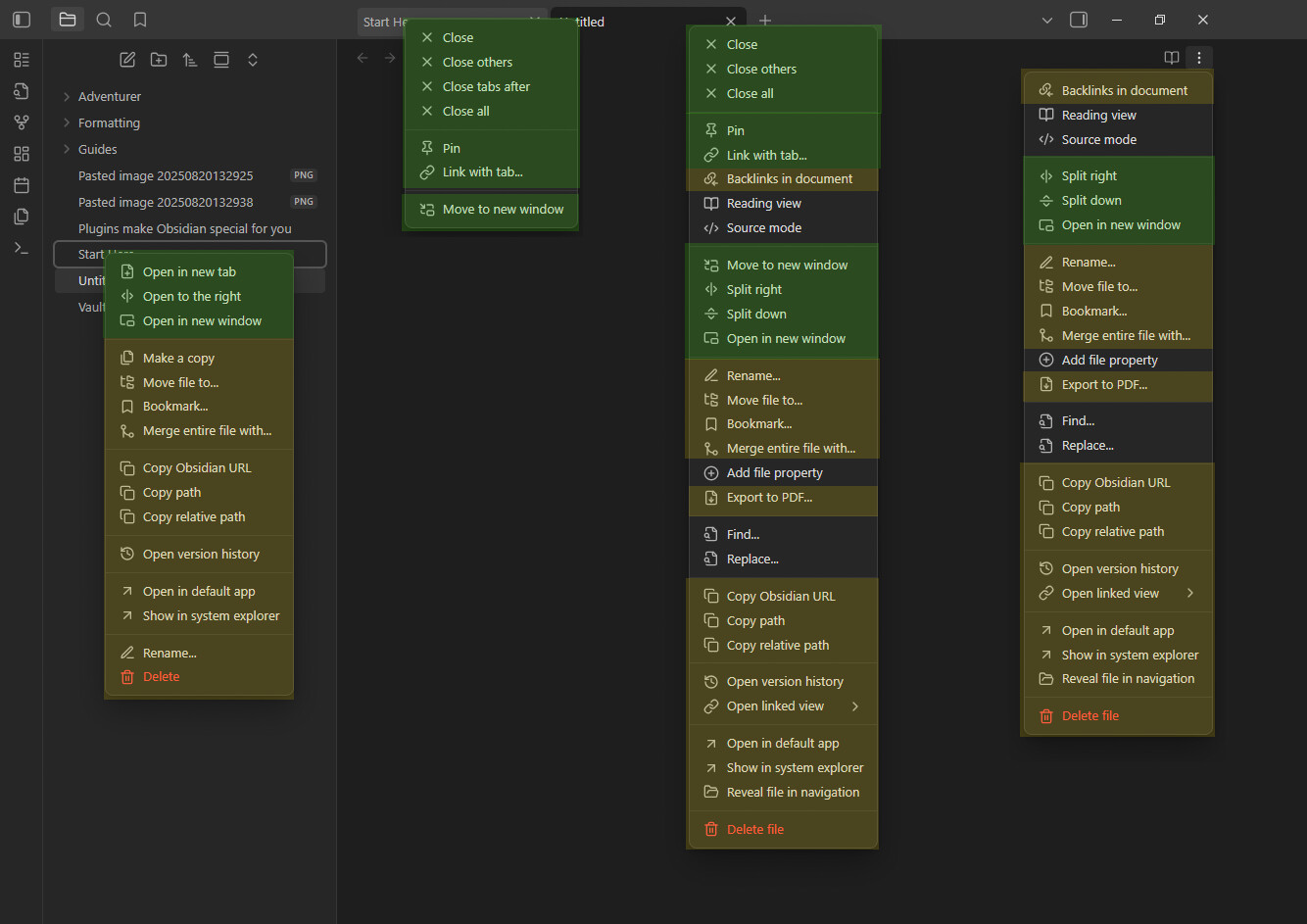

Let’s compare context menus of a file inside files view, unfocused tab, focused tab and three dot menu:
Highlighted in green are tab-related commands, in yellow(ish) are file-related commands, and unhighlighted are file content commands (at least how I interpret them).
(Edit: “Backlinks in document” and “Open linked view” probably would’ve been better uncolored, as more related to content.)
You can see them intermixed, and that makes it difficult to find anything.
This is another illustration for my past comment.
It might be possible to enforce grouping of commands based on scope:
  • tabs and layout;
  • note file as a whole
    • might be possible to further categorize into modifying and non-modifying commands;
  • content (presentation and editing).
