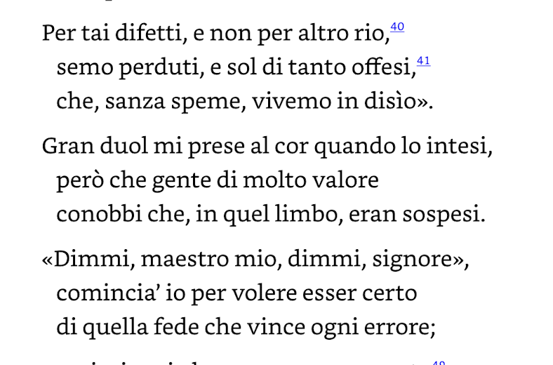

Markdown formatting lyrical verses
I tried to format some lyrical verses with Markdown: Example
I tried all command like > and : , but they did not work.
Any ideas!

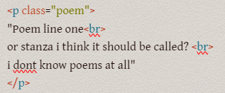

I’m new to CSS and HTML and Obsidian customization myself but I think that’s something that a .css snippet might be best for. You were trying to get an indent on all line following the first, right? The closest I managed to get was by using this .css snippet:
.poem {
text-indent: -2em;
line-height: 1;
width: 30em;
margin: 5em;
text-align: left;
Which gave me this:
When written like so:
Important to note that removing <br> will write everything as a continuous line.
You can also use <div class=“poem”></div>
You can change all of the values in the snippet so that everything looks how you want it, but from what I’ve tried, the text-indent must always be a negative value when using this method.
