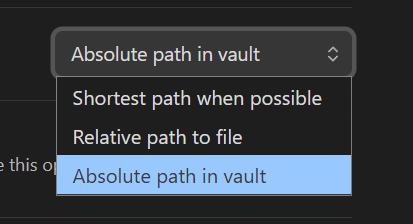

I wonder if it’s happening because Hugo expects a full path whereas Obsidian doesn’t. If that’s what’s causing the broken links in Hugo, then Obsidian’s Settings > Files and links > New link format > Absolute path in vault might avoid the problem for links you create from now on. (Or try the relative setting if Hugo uses relative paths.)
It wouldn’t automatically change links you’ve already created though.
