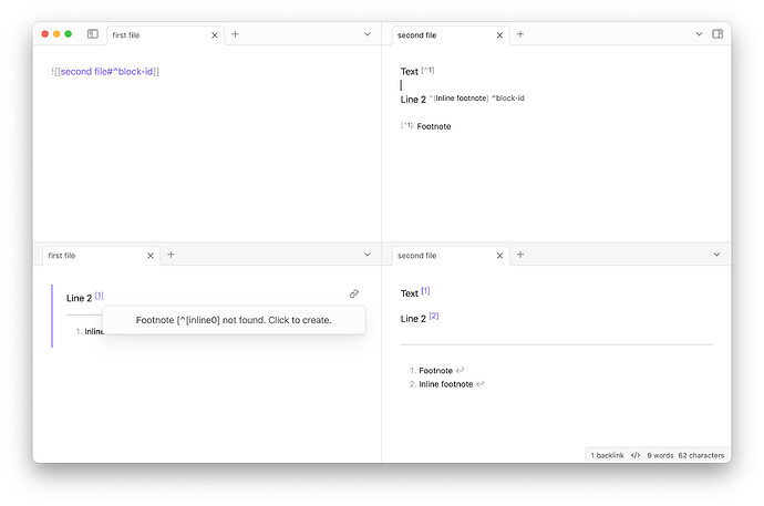

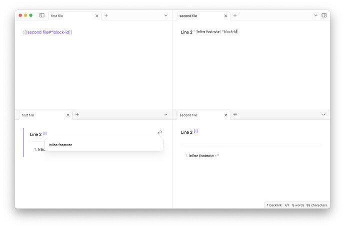

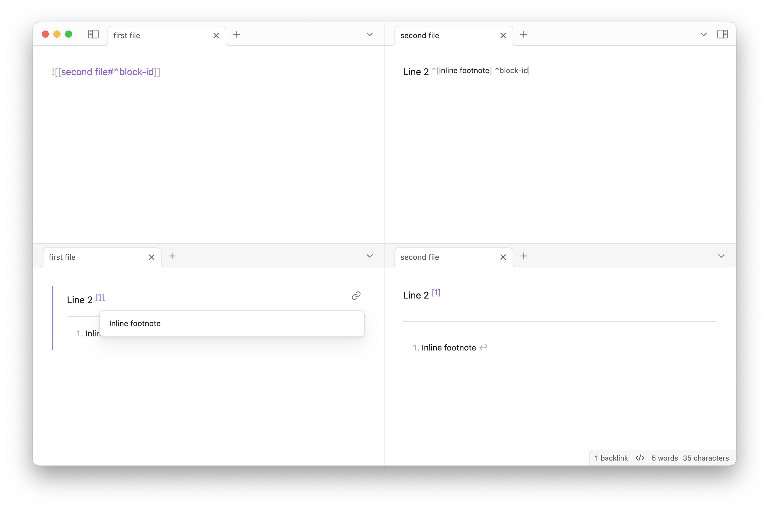

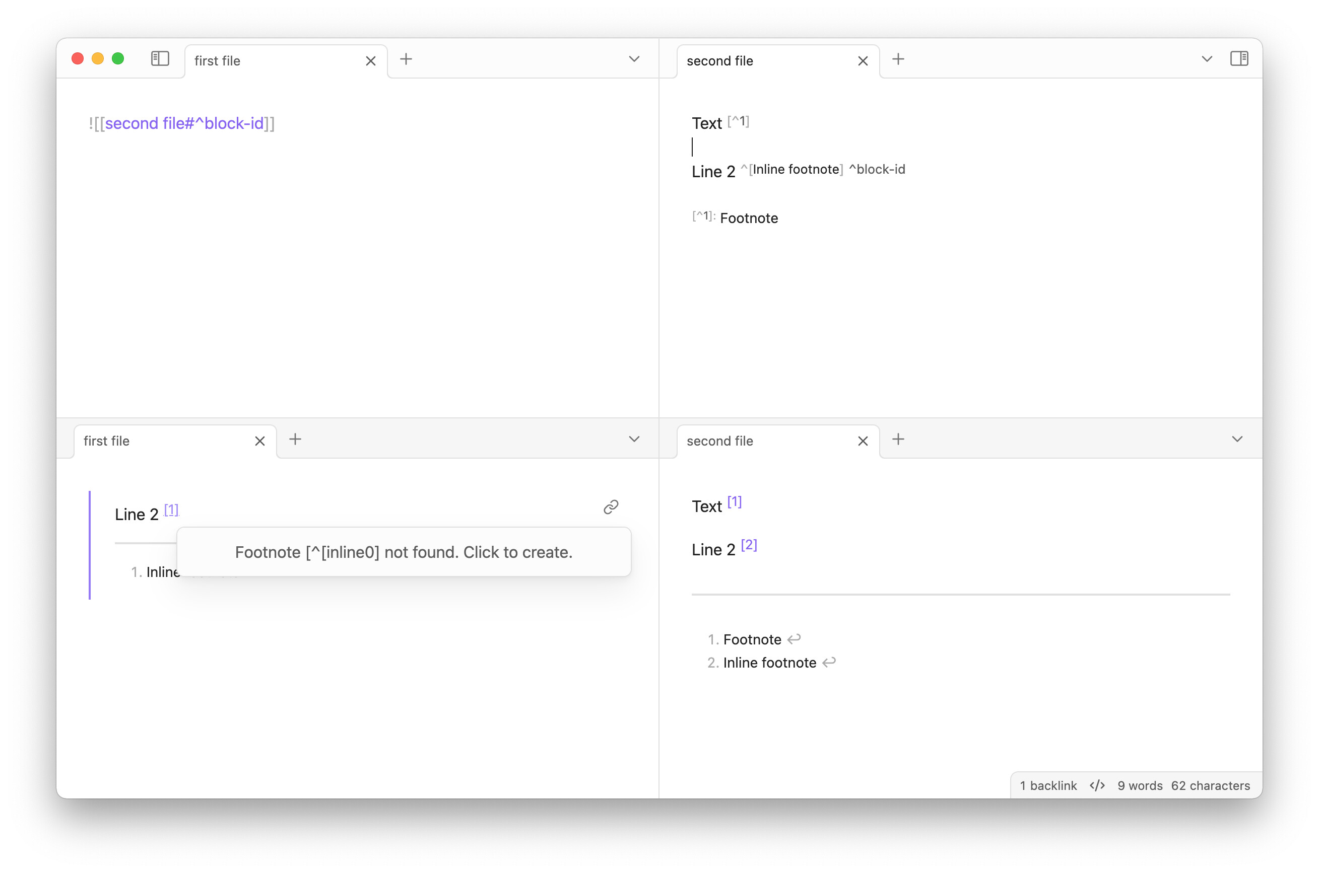

Another thing worth pointing out is that when:
  • an inline footnote is sandwiched between a regular footnote (i.e. [^1]) and its detail (i.e. [^1]:) in its original note
  • that inline footnote is embedded in another note
  • a page preview (hover preview) is opened for that inline preview in the embed in the another note
then that preview breaks:
Screenshot with inline footnote sandwiched between regular footnote and its detail
Screenshot with inline footnote before regular footnote and its detail
Screenshot with just inline footnote
This is probably the same bug, so I will put it here.

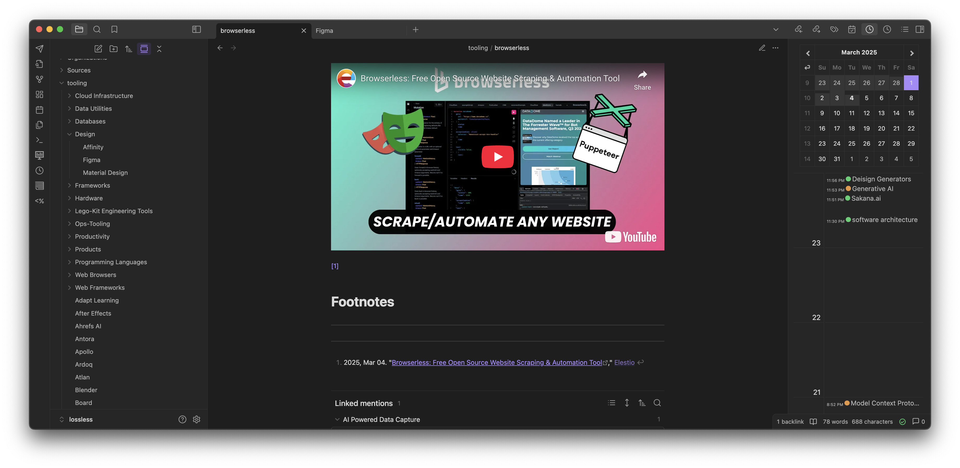

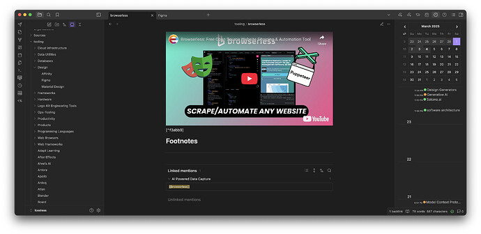

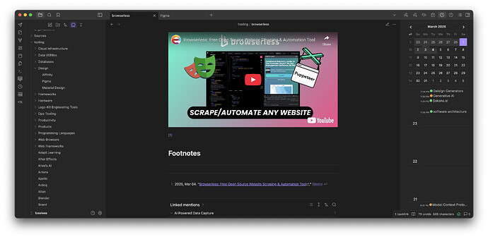

A footnote isn’t rendered as a footnote if it’s the line below an HTML embed. If it’s two lines below, it works. One line above, it works (but renders like it’s two lines above).
Expected behavior:
I actually want to add footnotes to the SAME line as an HTML embed, but I would take the line below.
