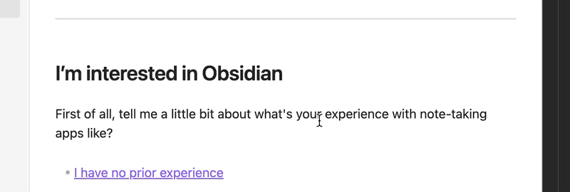

You should be able to select the text and type the ` (backtick) key once:
CleanShot 2025-04-29 at 17.42.20

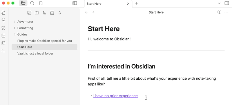

There’s also the Toggle code command you could assign a hotkey (it’s unassigned by default):
CleanShot 2025-04-29 at 17.46.08
