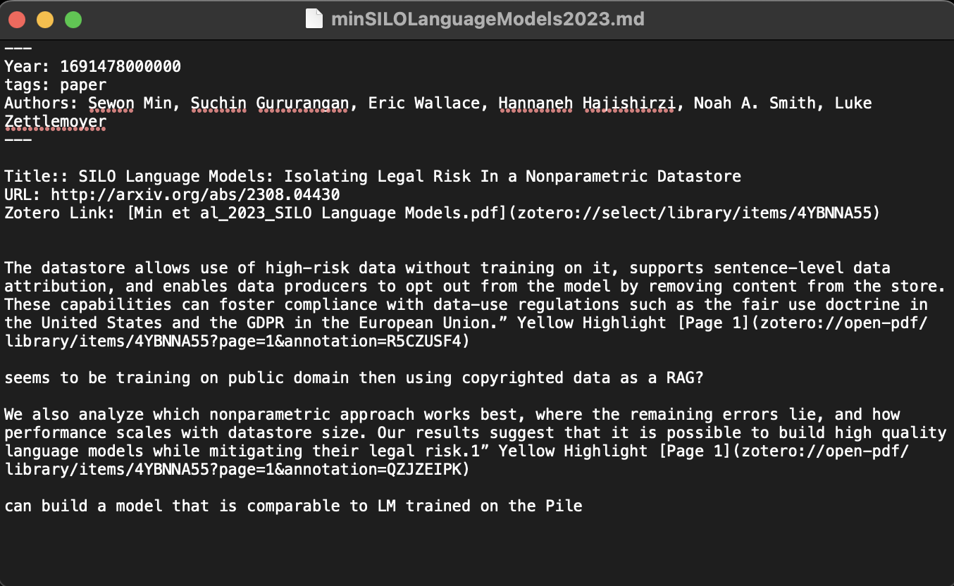

This is what the markdown file looks like which can be opened in the default TextEdit on Mac but not able to open it in Obsidian even though I moved it to the vault
I’m still suspecting your file extension to be strange. More specific I’m thinking that your file ends with .md that’s with an extra space at the end.
So try in Finder to change the file extension into something else, like .txt, and then change it back into .md.
Excellent guess! I can recreate the issue if I rename a file with .md␣ with a space.
