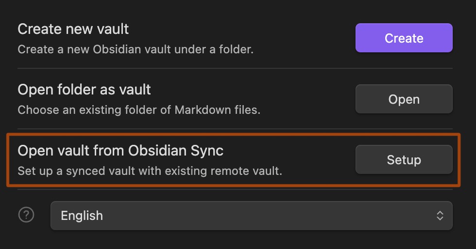

Sorry to hear you went through this. No I don’t believe that’s how it’s supposed to work. It sounds like you created a new vault first. In the Sync a remote vault on another device, the steps say to choose “Open vault from Obsidian Sync”. And from that setup process, you’ll create and name a new local vault that will pull down from the remote version.
Sync tools are not intended to be backup tools! Keeping backups is an excellent and crucial idea. From that link above:
Prerequisites
Recommended: A backup system in place for your Obsidian files on your most-used device. A syncing service is not a backup.
