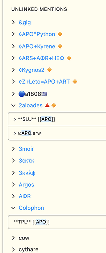

some of my active links stays in UNLINKED MENTIONS tab.

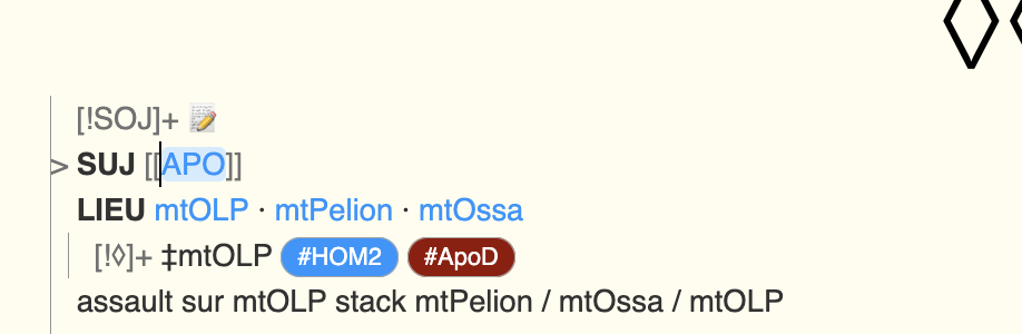

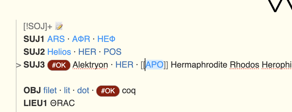

i figured out its probably linked to some syntaxe :slight_smile : if i cut paste the same link in a different place of the document, the links switch to MENTIONED LINKS tab
here are some screenshot of the “unlinked” active links
for [[APO]] links
(community plugins updated, i tried to restart and the problem persist in sandbox vault)
any idea?
unlinked mentions:
if i click on LINK button, it just add more [] without swithcing it to linked mentions
also, the links are not appearing in the graph view mode

hello.
anyone has a clue about why links are not mentionning?
it suppose to link but it doesnt,
in the Backlink tab : the link stays in “unMentioned Links”.
if i click the LINK button, it just add me [] infinitely without putting it in the “Mentioned Links”
it makes me this with maaaaany links and I still cant find why
it is absolutely anoying as I use obsidian for its ability to link nodes only…
thanks for reading
how does the document look like in reading view?
solved :
thanks for the hint,
the link actually doesnt show in MENTIONED category because it was part of a paragraph that was not separated from : < h1>< center>TITE< /center>< /h1>
i use that to make centered big titles in my notes
