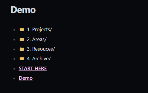

This produces for example:
So it works!
So it also works.

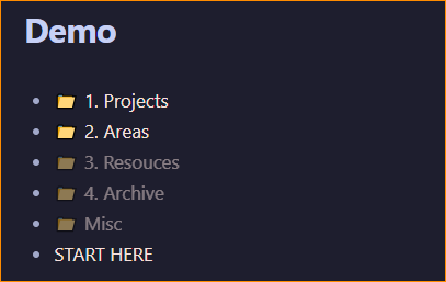

This way every folder is clickable. If a note with the same name as the folder exists inside it, the link leads to that note. If it does not exist, the link leads to the creation of that note. Visually, all links have the same aspect, whether the target exists or not, because the html generated by dataview does not insert the appropriate class (is-unresolved) for the non-existing elements. That’s unfortunate, but you can detect which ones do not exist by hovering (+Ctrl) the link.
Final version
I coded a solution in which unresolved links to folder notes have the proper style/color.
This solution uses dataview custom views, which has also the advantage of reducing the clutter in the notes, since the code to be inserted is now minimal. This is the snippet required in folder notes:

Then, every note containing the call to await dv.view("Misc/Views/folder_list"); will show something like:
(in this example, “1. Projects” and “2. Areas” also contain folder notes, while the other folders do not)
