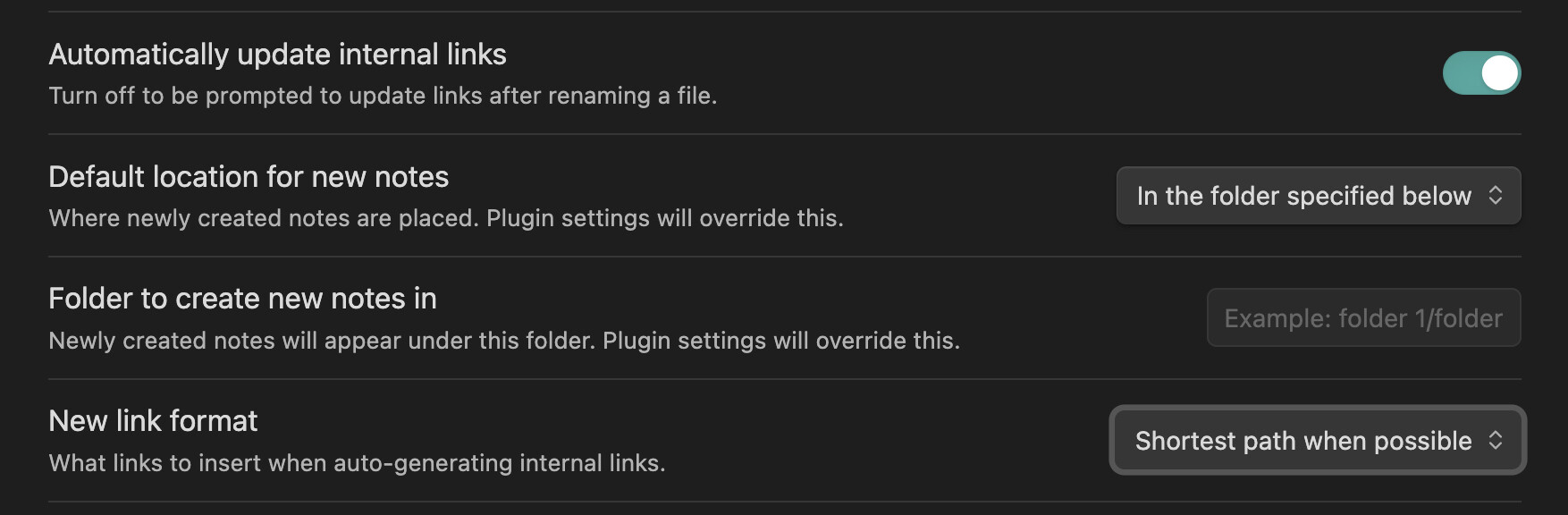

First, I forgot to suggest some setting to check (although it’s weird that it recently changed behaviour):
  1. Is “Automatically update internal links” turned on?
  2. What is your “New link format” set to?

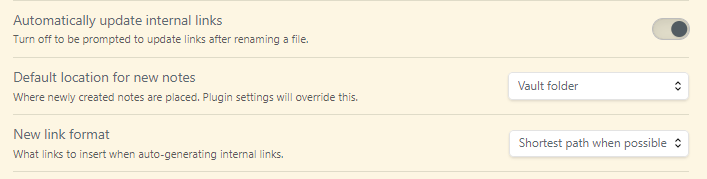

Ok. Here we go.
  1. All plugins are up to date.
  2. My settings look similar to yours:
