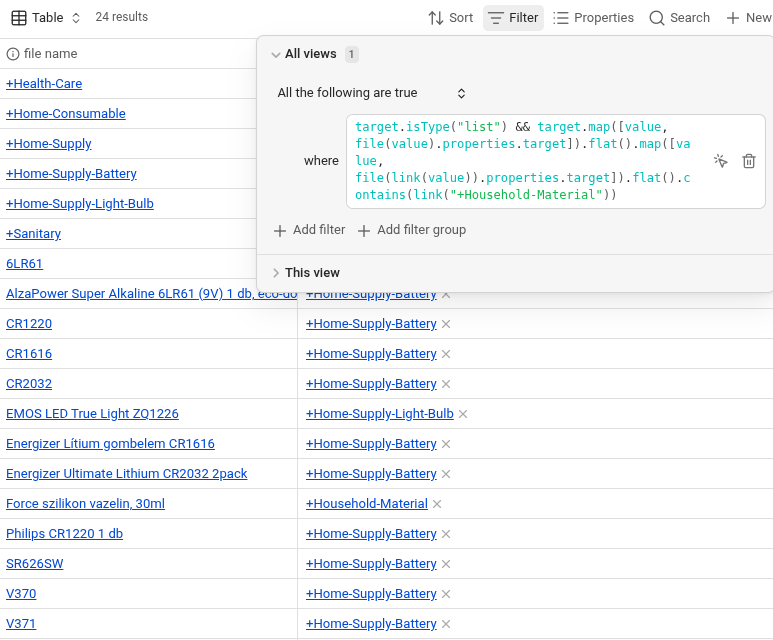

1. Evidence: Comparison of Behavior
The code below demonstrates that the first map (before .flat()) works without link(), but the second map (after .flat()) requires link() to function, even though the logical data is identical.
JavaScripttarget.isType("list") && target.map([value, file(value).properties.target]).flat().map([value, file(link(value)).properties.target]).flat().contains(link("+Household-Material"))
2. Success Pattern: Recursive Tracing

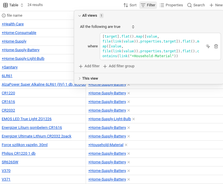

By explicitly re-casting with link(value), I can successfully trace properties through multiple levels of a tree structure.
JavaScript[target].flat().map([value, file(link(value)).properties.target]).flat().map([value, file(link(value)).properties.target]).flat().contains(link("+Household-Material"))

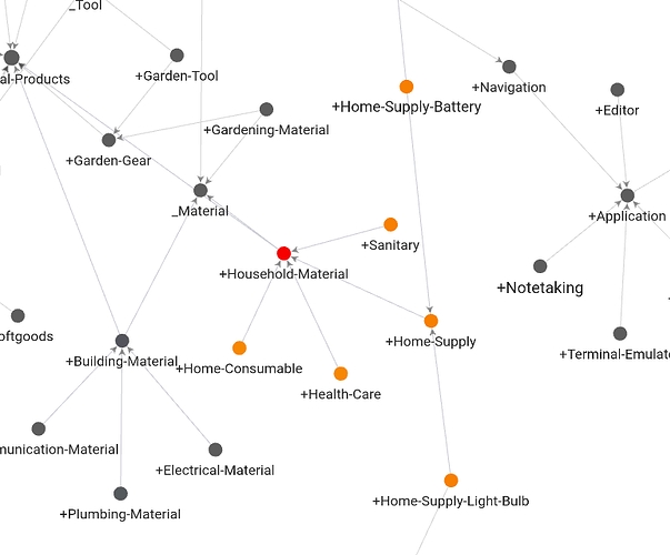

3. Use Case: Tree Structure Categories
My vault utilizes a tree structure for categories (e.g., SanitaryHome-SupplyHousehold-Material). Recursive tracing is essential for filtering items based on ancestor nodes in this tree.

Thank you for the feedback. I realized my previous steps were inadequate, so I’ve rewritten the reproduction steps from scratch.
Corrected Steps to Reproduce:
  1. Create three notes: NoteA, NoteB, and NoteC.
  2. In NoteB, set a property target to [[NoteA]].
  3. In NoteC, set a property target to [[NoteB]].
  4. In the Bases Advanced Filter, use the following expression to trace the property through a manually flattened array: [target].flat().map([value, file(value).properties.target]).flat().contains(link("NoteA"))
  5. Observe that property resolution fails, and NoteC is not returned in the results.
Technical Comparison:
If the expression accesses the list directly without wrapping it in a manual array (avoiding the first [target].flat()), it works as expected and returns both NoteB and NoteC:
target.isType("list") && target.map([value, file(value).properties.target]).flat().contains(link("NoteA"))
Observation:
The issue seems to be that while the target property itself contains Link objects, elements in a list created/processed via certain array operations (like [target].flat()) lose their functional “Link object” properties. As a result, file(value) fails to resolve metadata.
To make it work within the flattened structure, I must explicitly use link(value) to “repair” the type:
[target].flat().map([value, file(link(value)).properties.target]).flat().contains(link("NoteA"))
I believe this shows that Link objects are losing their prototype or internal type-tagging when handled within these array structures.
