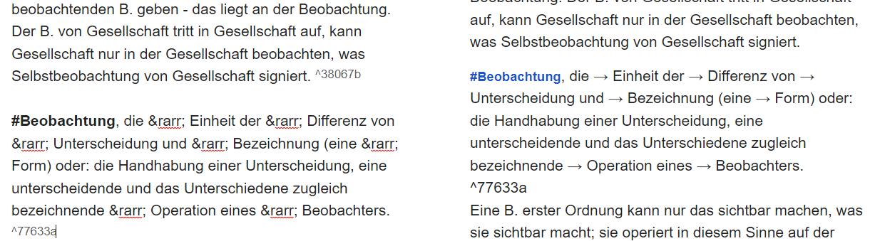

do you have an idea, why it works on the first link perfectly “^38067b” shows not in the “reading mode” and the second one “^77633a” it is visible in the reading mode?

[[B#^38067b|Beobachter]]
the following is from a footnote:
[^4]: Vgl. im Lexikon: → [[B#^77633a|Beobachtung]]
is this the problem, thats in a footnote?
Could you paste the same text you showed in the screenshot, so we can see the ^77633a in its context? I suspect it needs a blank line under it or to be moved to the end of the preceding line.
:slight_smile: thank you! that’s it… blank line under it and all is good :slight_smile:
