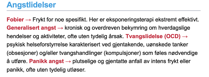

I recently switched to Obsidian on Mac because trying to print my notes from OneNote was a big pain in the ass. A problem that has occurred with this app is that when I export the file to PDF, it doesn’t really match what it looks like before I export.
The main issue is when I hit enter before a sentence is finished. It squeezes those lines together when exporting

I’m adding a couple images, the second one is what the PDF looks like and how the lines get pushed together instead of staying separate.
To create a line break or new line (<br> ), end a line with two or more spaces, and then type return.
edit: I neglected to mention, but you’re most likely to see the behavior in your export screenshot with Settings > Editor > Strict line breaks enabled. You could use the double spaces or if you disable that setting, you should be able to do without them at the end of paragraphs.
