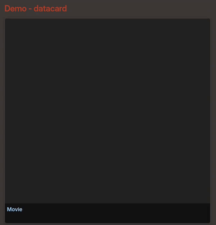

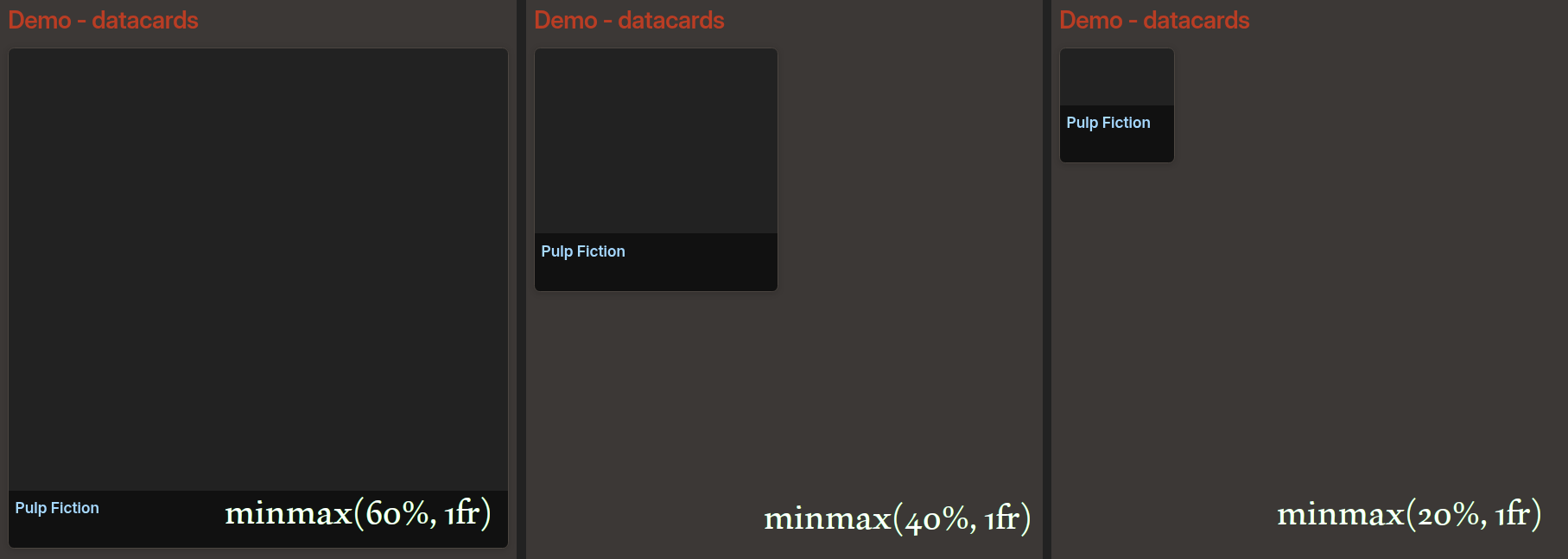

I checked Datacards settings reference … nothing, so here’s a CSS solution. It’s not perfect but it should be flexible enough for your needs.

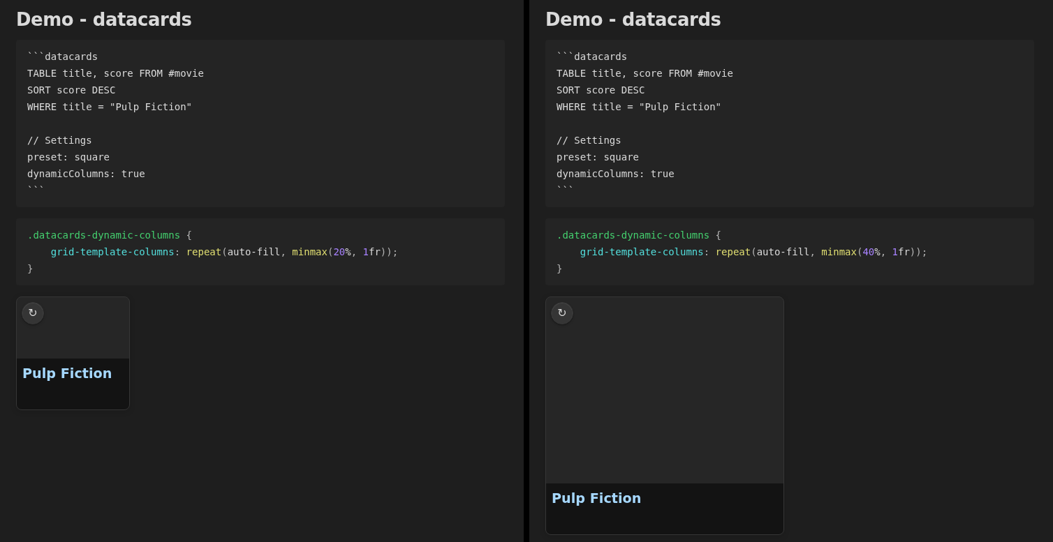

datacards - demo
Code used for the demo
```datacards
TABLE title, score FROM #movie
SORT score DESC
WHERE score >= 8
// Settings
preset: square
dynamicColumns: true
CSS solution
.datacards-layout {
  .datacards-dynamic-columns {
    grid-template-columns: repeat(auto-fill, minmax(30%, 1fr));
In the demo above, I used 60%, 40%, then 20%. If you want a fixed size for your cards, you can use pixel values instead of % → minmax(200px, 200px). Follow the instructions below to create your own CSS file if needed, then paste the code in it.

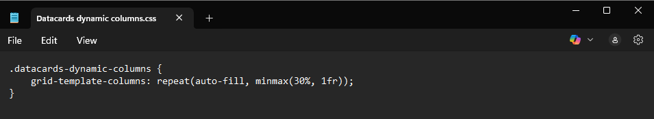

I’ve made the CSS snippet (I tried both codes, and neither have impacted the vault). I currently have the second one, because I thought I must be applying the CSS class incorrectly, somehow, but this isn’t affecting the vault, either:

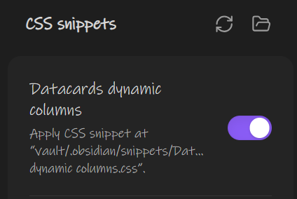

It’s activated:

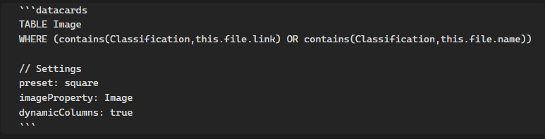

And I’ve added dynamicColumns to the datacards query:
This is how it renders:

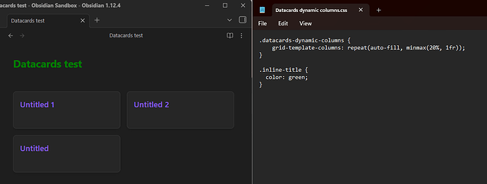

Can you reproduce this in the sandbox vault ?
I only installed dataview/datacards then linked to a new CSS file:
    grid-template-columns: repeat(auto-fill, minmax(20%, 1fr));
Add the green title snippet to see if everything is linked correctly:
.inline-title { color: green; }

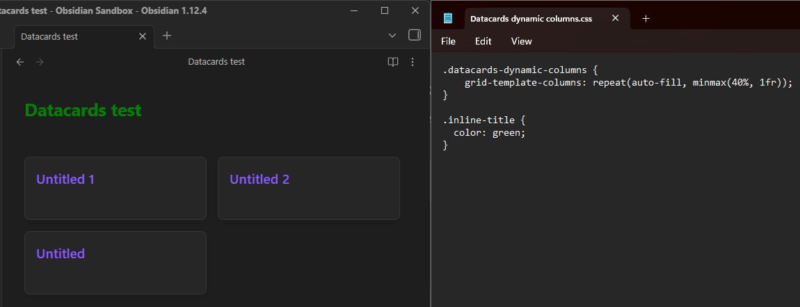

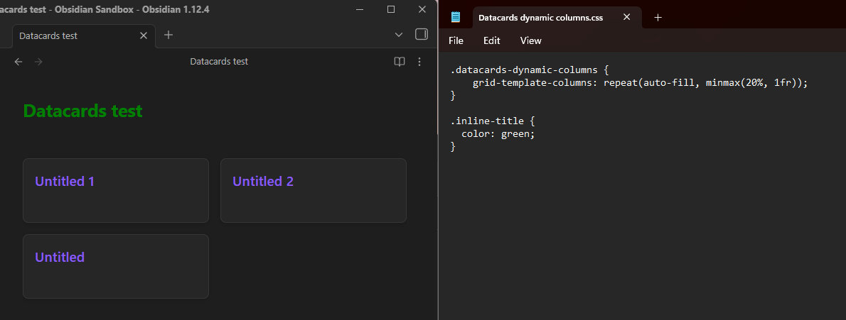

I want to know if you’re able to change the size of the card by editing the percentage from 20% to 40% in the CSS file.
The title has turned green, but the datacards sizes appear the same:
With 20%:
With 40%:

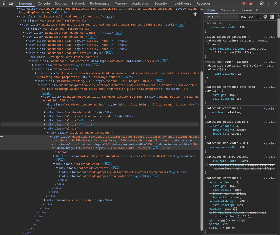

I increased the CSS selector specificity, it should work:
.block-language-datacards > .datacards-container.datacards-dynamic-columns {
  grid-template-columns: repeat(auto-fill, minmax(10%, 1fr));
If it still doesn’t work, we’ll have to dig deeper.

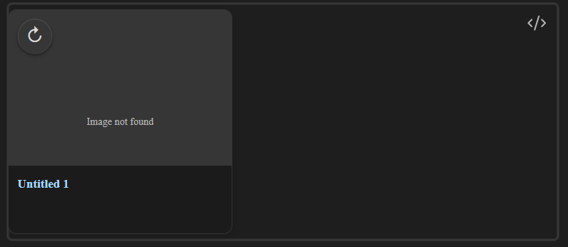

Sorry it’s taken a few days to reply. I’ve just tried it out, and it worked! Though not in split screen.
This is how large it looks. This is in my regular vault.
And in split screen:
(Also thank you so much for your effort/persistence; I appreciate it. This problem ended up bothering me more over time than it did when I originally posted :joy: )

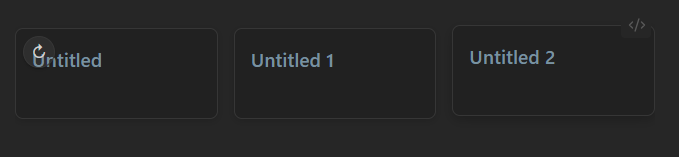

It works the same in split screen on my end. You might prefer this snippet where you simply choose the number of cards you want per row.
  grid-template-columns: repeat(3, 1fr) !important;
