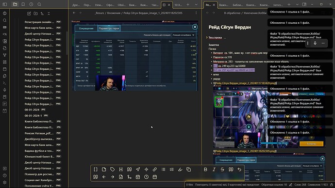

Has anyone experienced disappearing screenshots when adding text to notes with embedded screenshots created on a smartphone and viewed on a computer in Obsidian? I’m using synchronization via Google Drive and have also created a separate folder named .obsidianmobile to speed up launching the mobile version with minimal plugins. It seems that PDF files are also affected by this issue. How can this be resolved?
I don’t have an answer, but for other people reading this to know: the popups on the right side of the screenshot, it is Obsidian warning that the file was edited externally.
