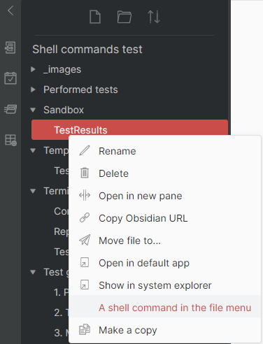

There is file menu event and {{event_file_path}} variable when you use Shell commands plugin.
https://publish.obsidian.md/shellcommands/Events/File+menu
That shell command (in red) can access file specific information using the {{event_file_path}} variable.

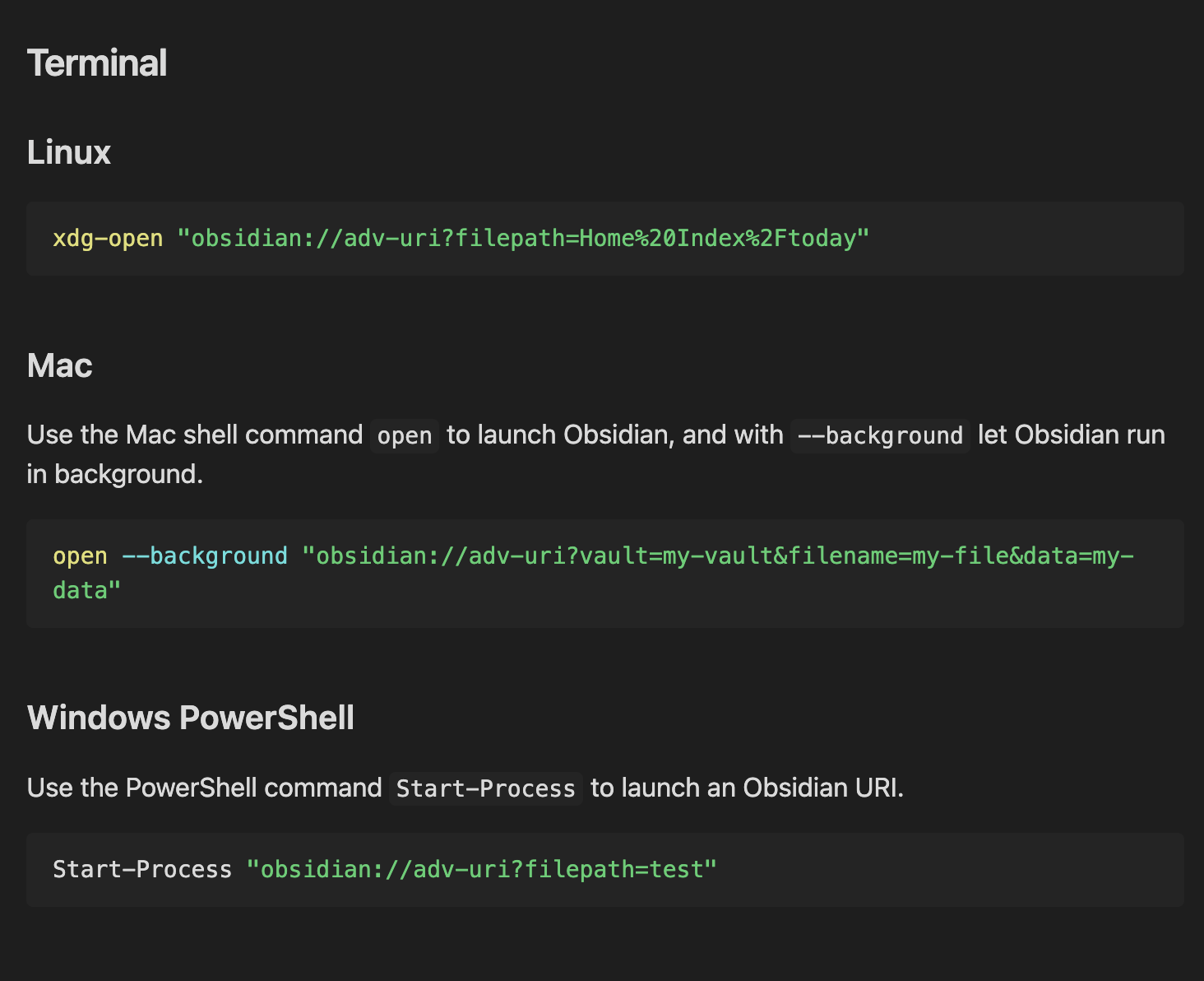

The last part of executing Templater using command line is still missing though. You could instruct Templater using Advanced URI but this requires simulating the file opening and then closing it. There is openmode=silent but I’m not sure does it work (https://publish.obsidian.md/advanced-uri-doc/Concepts/Navigation+Parameters).
Here is the “replace templates in the active file” command uri:
obsidian://adv-uri?commandid=templater-obsidian%3Areplace-in-file-templater
Then use filepath={{event_file_path}} i.e.
obsidian://adv-uri?filepath={{event_file_path}}&commandid=templater-obsidian%3Areplace-in-file-templater
and openmode=silent:
obsidian://adv-uri?filepath={{event_file_path}}&commandid=templater-obsidian%3Areplace-in-file-templater&openmode=silent
(I haven’t tested above)
The exact shell command is system specific:
https://publish.obsidian.md/advanced-uri-doc/Getting+started
