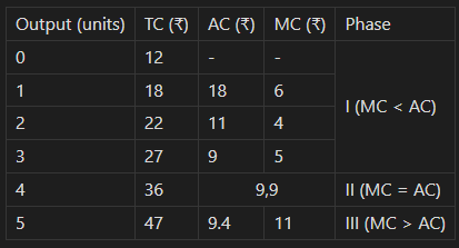

I have found a way to merge cells both columns and rows in obsidian.
We can make tables using HTML & CSS. Cells of tables made with HTML can be merged with your text for rows and
your text for columns. i haven't found any community plugin to make the process easier. But I have found a way to make the process a little easier, we can make a table in excel and paste it in this site https://tableconvert.com/excel-to-html this will convert our table to HTML but it removes merged cells so we have to manually add the merge part wherever we want to merge.
Here is the result:
The result will be clear only in reading mode or after it is exported.
