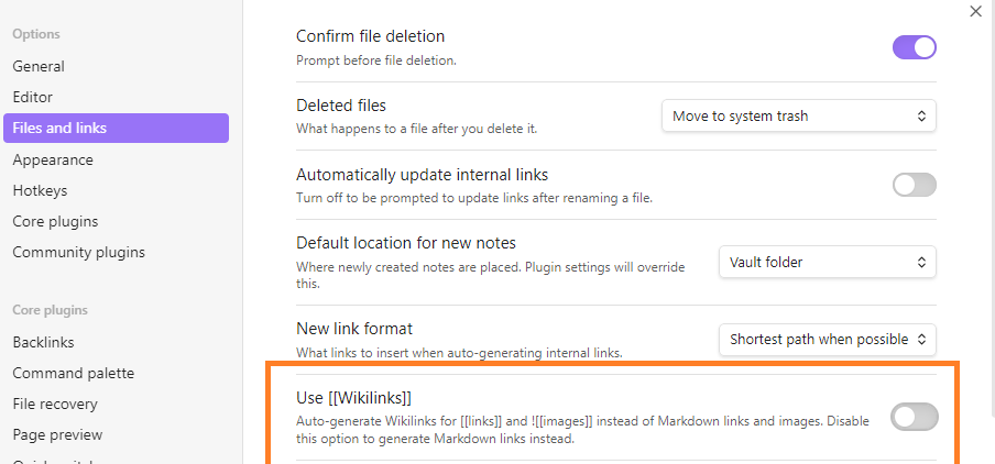

You can turn off Use [[Wikilinks]] in Settings:
but still use the suggester when creating links to headings (and blocks). Once you have linked to what you want, hit enter/return and a Markdown link will be created.

If the WikiLink is switched on then starting with [[ and completing using a tab helps to construct the link to another page’s sub heading.
However, if the WikiLinks are off, which is the way I use, because I need the standard markdown notation, then the auto-completion for the sub-heading of another page doesn’t work.
What happens is after completing the page link, the cursor jumps out to the end and even if you come back to the link to edit it so you can link the sub-heading, the auto-completion would not work.
