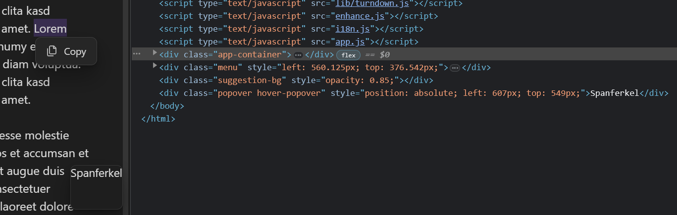

It seems i have to somehow find a way to use menu after all, because somehow Menu.showAtPosition() modifies the position to be in the right place, while just applying the position to a HoverPopover leads to the popover sometimes ending up in seemingly random positions, for from the inteded one. I dont know what kind of hacks/ transformations are used to get the accurate position in the .showAtPosition() method and i wouldn’t know how to find out. Maybe you have another idea.
Example:
