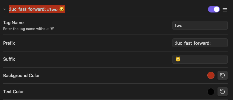

In the image below I’ve styled the #two tag with a Icon shortcode and an emoji, and as can be seen only the emoji is shown:
How to do this using Colorful tag
The trick to doing this using Colorful tag is simple (but a little deceiving). You need to go into its setting page, and hit the Add button on the top of the page, which adds a section below the three default sections.
See the one section with just the # displaying? Expand this and you can start customising that particular tag, like shown in this image for the example above:
Repeat this process for any tag you want to customise, and don’t forget to enable the customisation in upper right. When enabled the title of this section will show the customised tag, or when disabled it’ll just show the #two variant (unless you’ve done some global changes as well).
