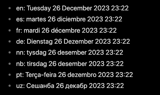

Here is an example Templater template that lists the a very localised days for various countries:
for (const co of ["en", "es", "fr", "de_DE", "nn", "nb", "pt", "uz_AF"]) {
  moment.locale(co)
  tR += "- " + moment.locale() + ": " + moment().format("dddd D MMMM YYYY HH:mm") + "\n"
As it stands this returned this list for me:
So your case to that format should be something like:
<%* moment.locale("de_DE"); tR += moment().format("ddd[, ]DD.MM.YYYY") %>
