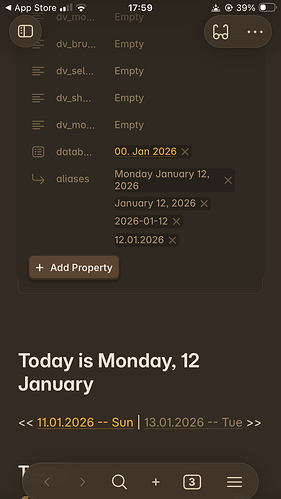

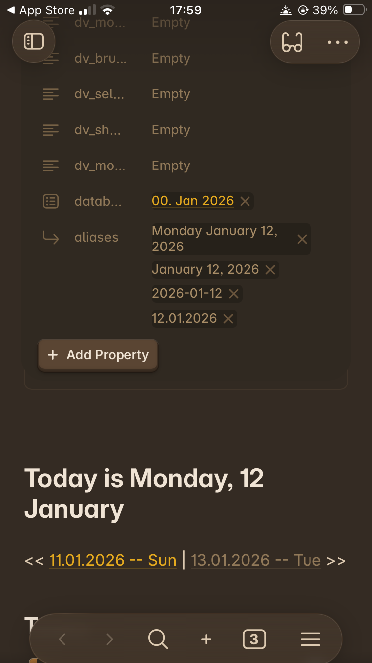

Same

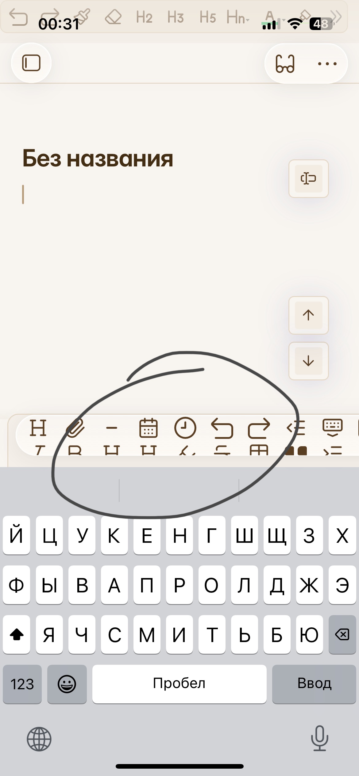

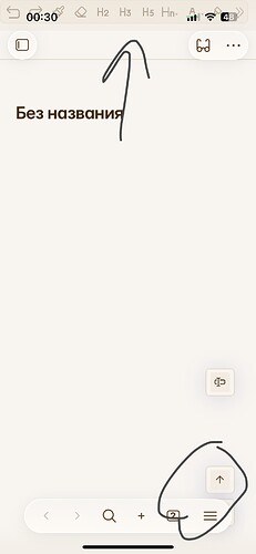

Have this thing not really pretty
Also some very useful plugins now don’t work as supposed to because it’s not flexible and looks off
I have iphone 13
Ios 18.4
Maybe you have a different problem. Did you try default theme and restricted mode on, restart Obsidian?
Yes

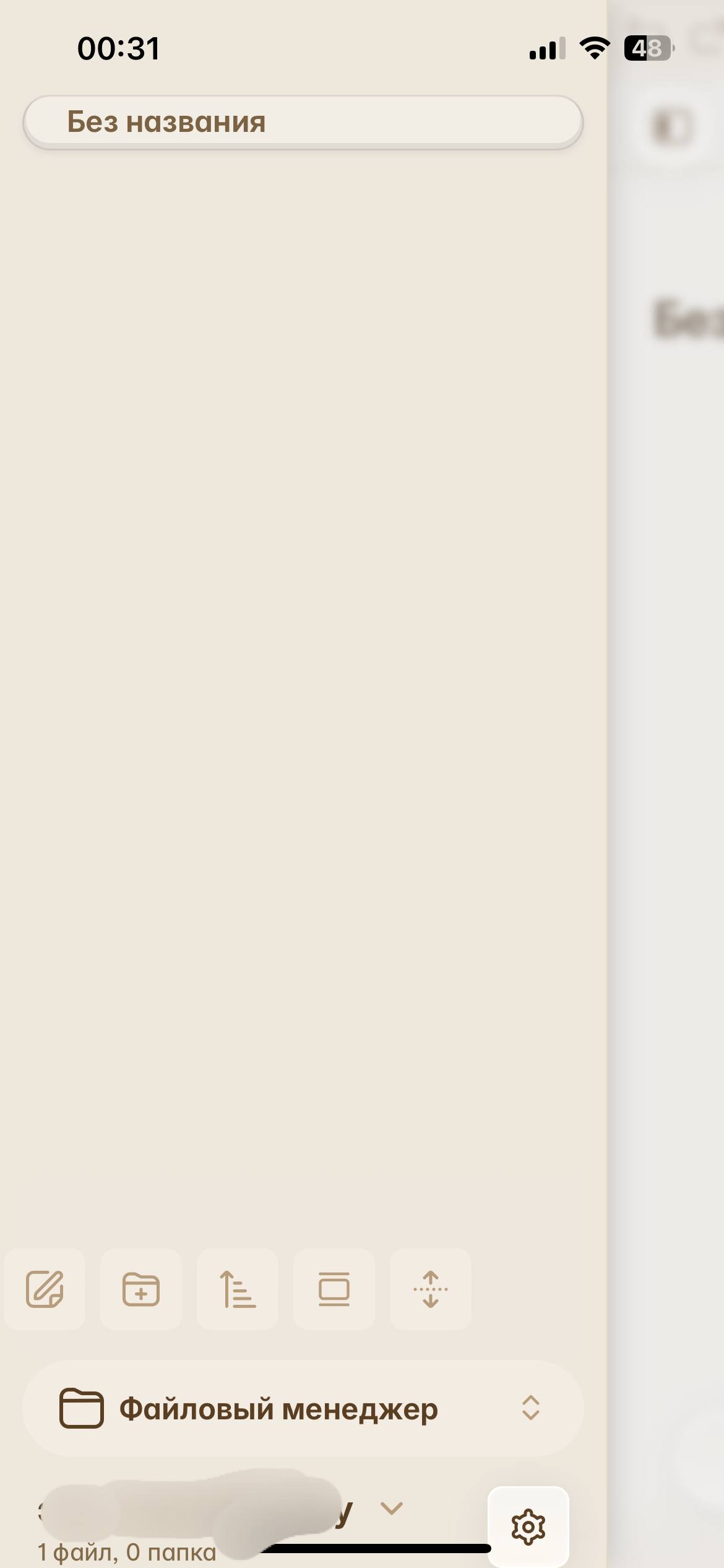

I’ve tested it in a new vault, with and without the theme - still have this problems
And btw is the new version supposed to not show the name on the upper bar? Cause I cant see where I’m writing, there used to be name written up there and now it’s empty

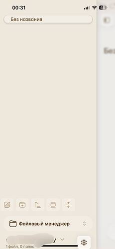

Can you post a screenshot of how it looks like in a new vault?
Can you update to newer version of iOS?
That is a new vault. Without the theme it looks almost the same
And no I have no plans to update ios as for now
If possible, I would like to see how it looks like in brand new vault. I am not sure you are affected by this bug.

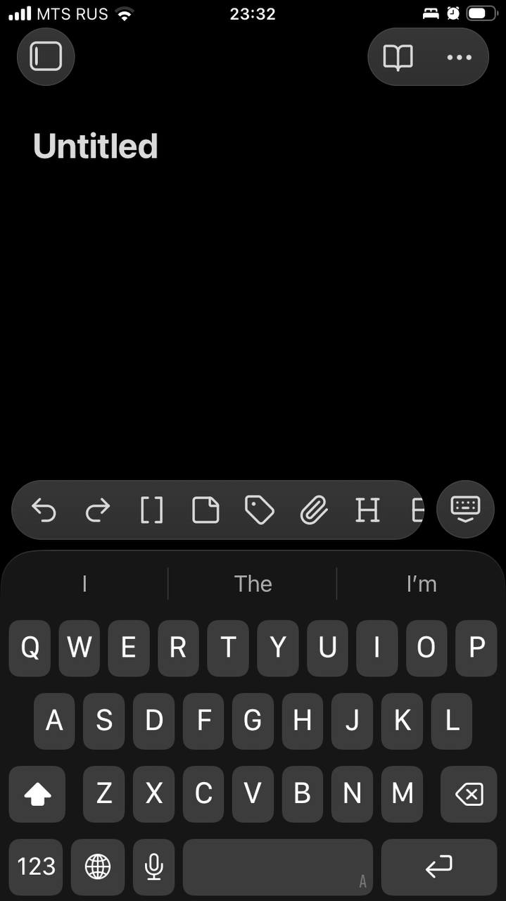

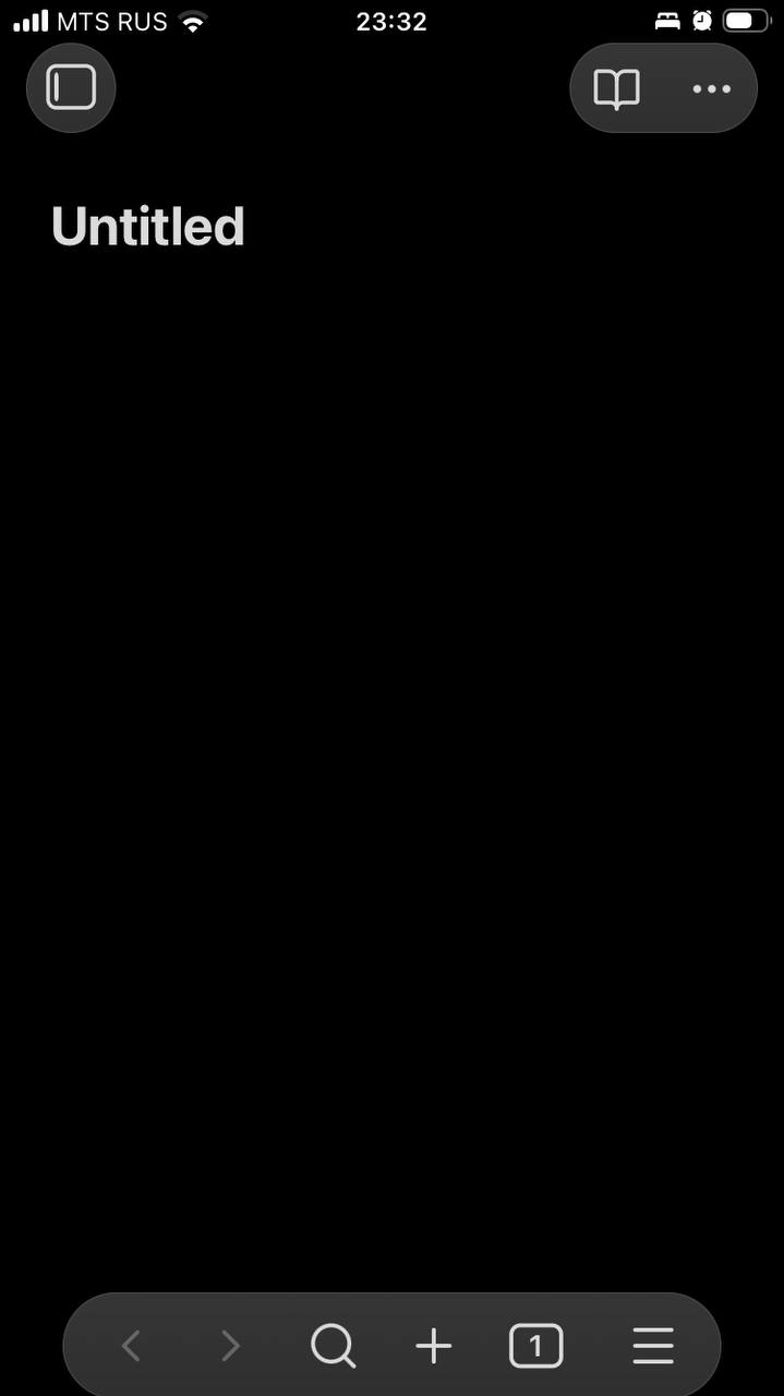

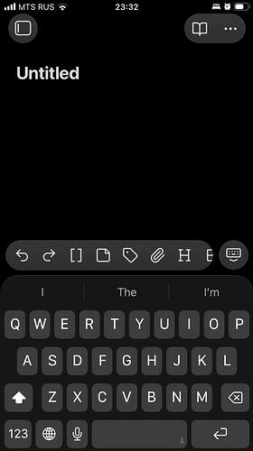

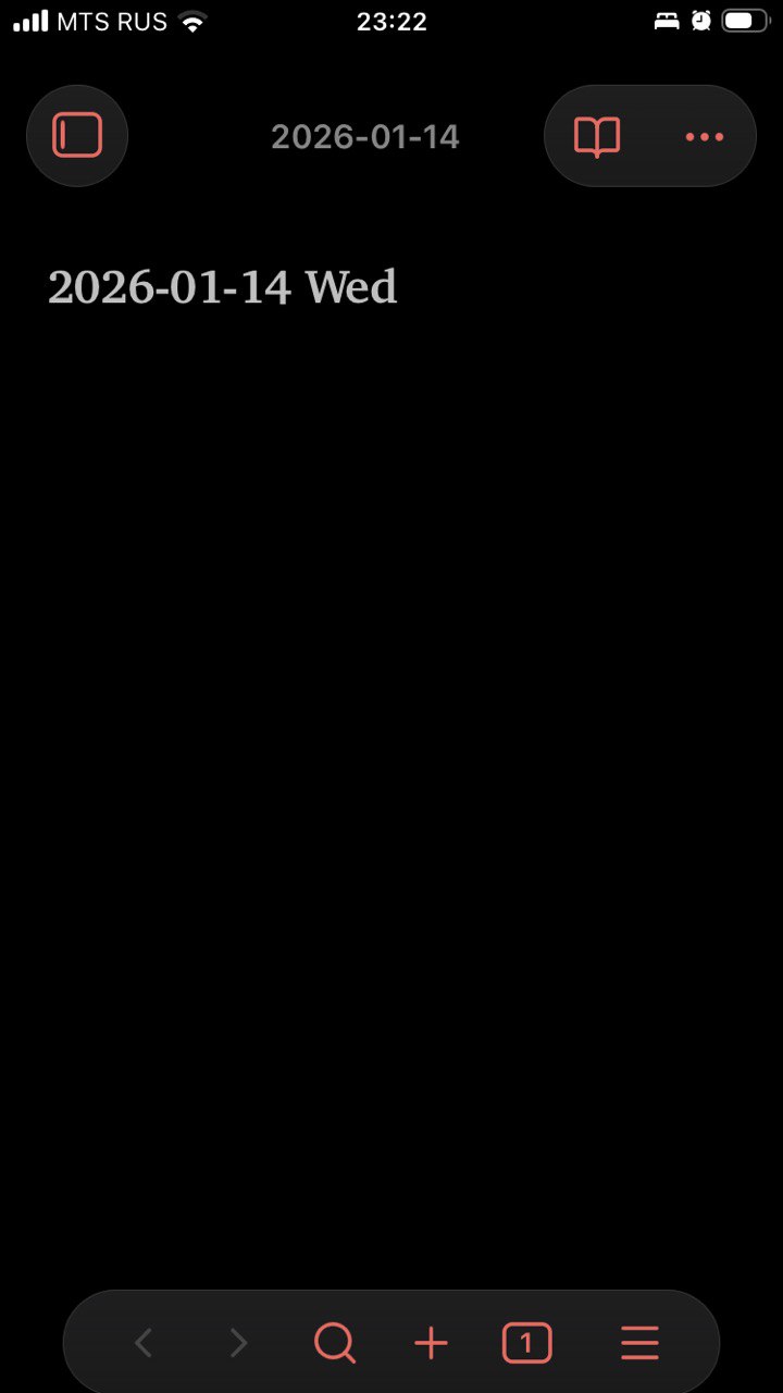

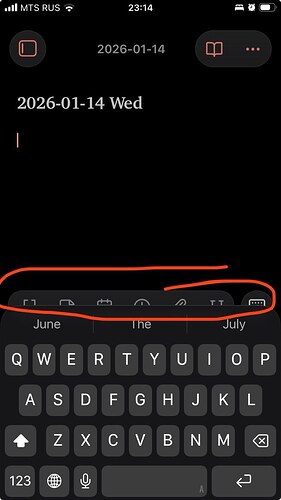

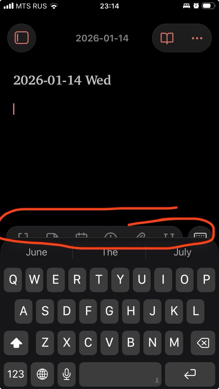

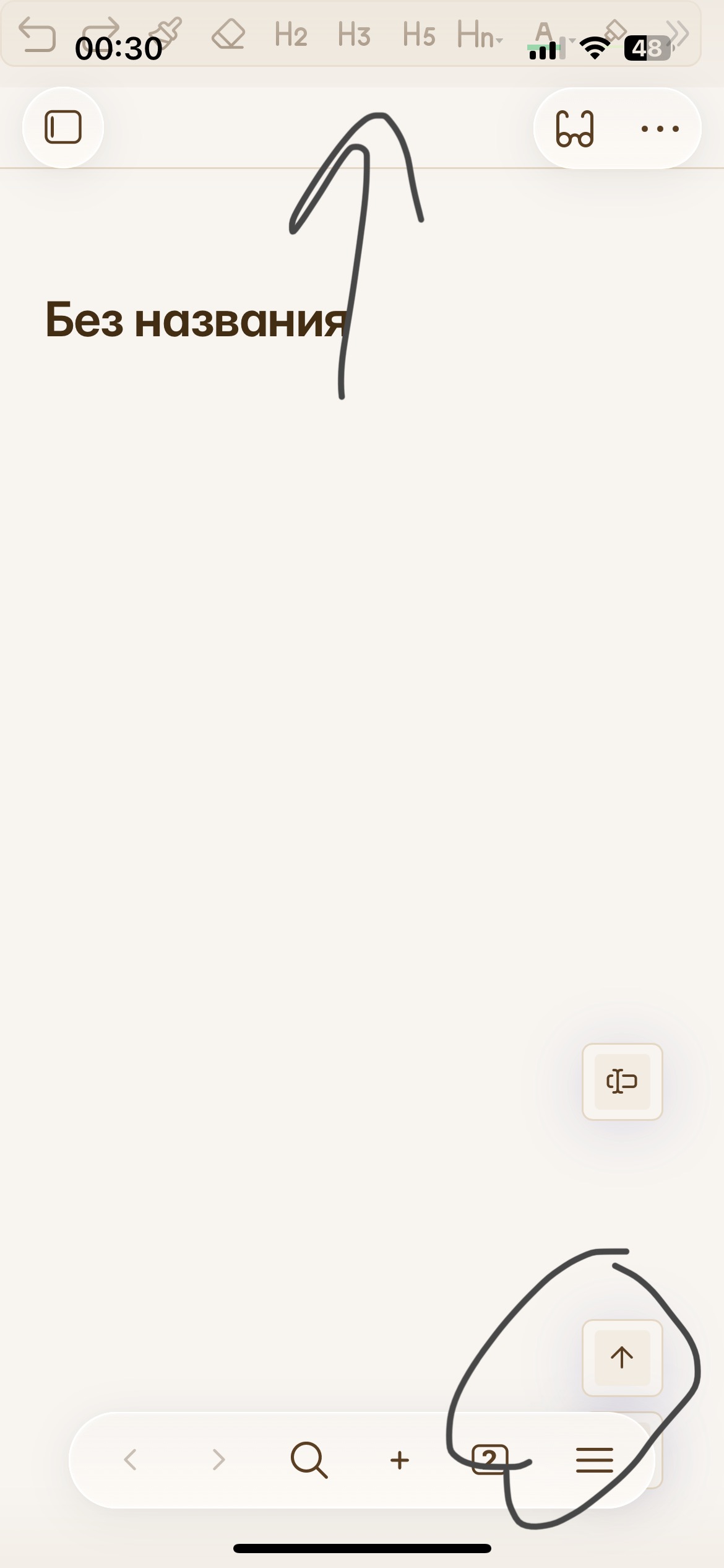

I have the same issue on iPhone SE (iOS 26.2) and similar problem with toolbar
I just tried to create an empty vault.
Status bar looks the same.
But toolbar looks good now :man_shrugging:
The status bar bug will be fixed in 1.11.5. the other is a theme/plugin issue, you need to report to it to theme/plugin developer.
