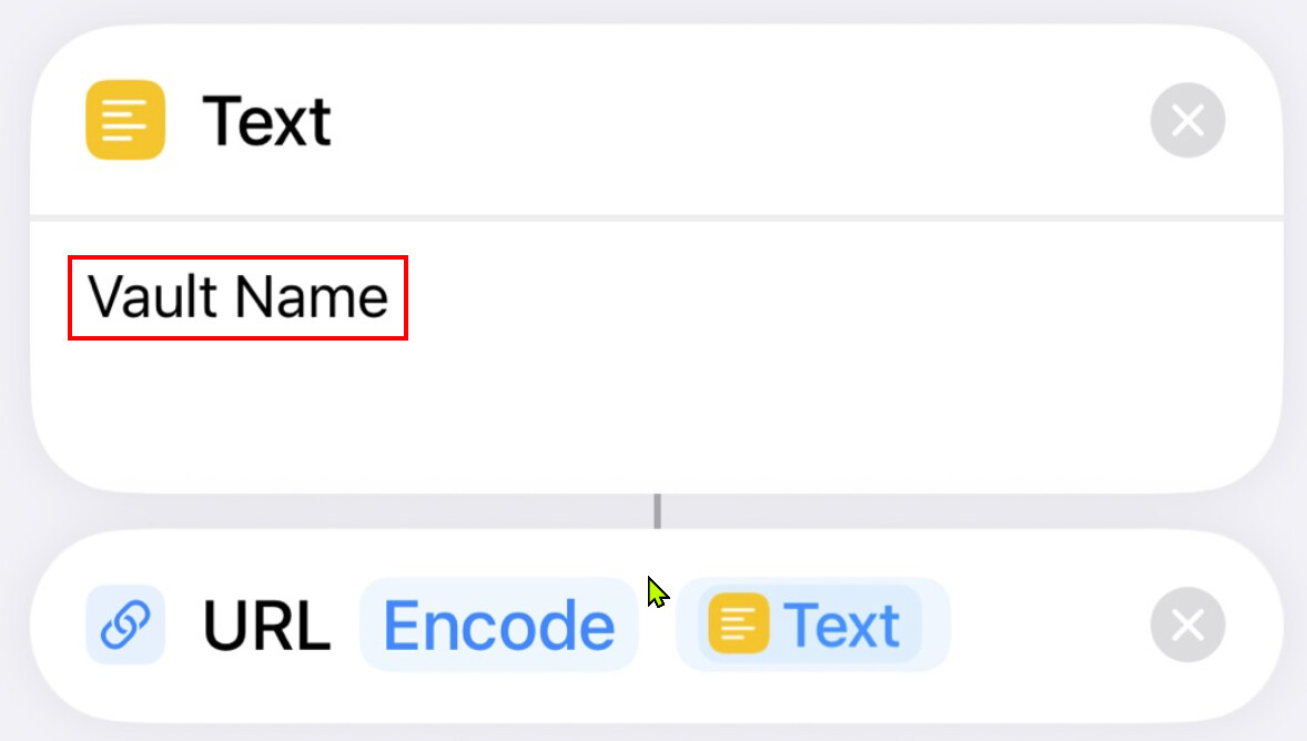

Just in case anyone stumbles across this trying to do something similar, I’ll post the outcome…
Shortcut link: it wouldn’t let me post the link.
The shortcut is a little crude, but it serves its purpose for now. Feel free to offer suggestions for improving it.

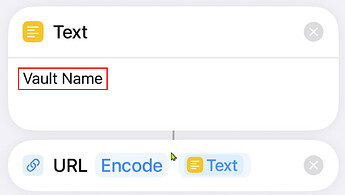

If you want to use it, the only change that should be needed for the shortcut is, your vault name.
The shortcut handles spaces in the name.
You’ll need the advanced URI plugin installed, the daily note to exist in yyyy-MM-dd format, with headings of ## Tasks and ## Notes.
It’s a nice way (for me) to capture notes or tasks quickly via either dictation or text. The pattern has the potential to be quite extensible.
