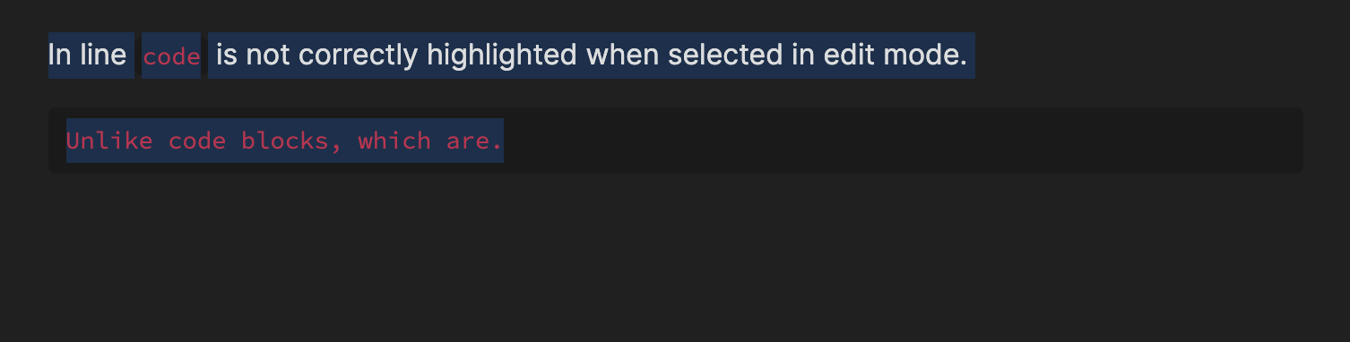

Most of the visual highlight that indicates what text is selected is occluded, seemingly by the background of the inline code:
Screen Shot Obsidian Inline Code Bug

Given a .md file with this content:
In line `code` is not correctly highlighted when selected in edit mode.
    Unlike code blocks, which are.
Select the text.
All the selected text to have the background for selected text applied.
The text in in-line code is not highlighted.

Hey, this isn’t a real solution but in case this was bothering anyone else, what I did was create a basic CSS file with the snippet:
.cm-inline-code {
    background-color:rgba(0,0,0,0.2) !important;
This basically preserves the appearance of the inline code blocks in the editor, although it still darkens the cursor slightly.
You can also make the background fully transparent, i.e. background-color:transparent !important;. This will make the dark background for inline code go away, (so it will look like other colored text) but will make the cursor fully visible.
I have a fix for this in this plugin I just put together GitHub - nothingislost/obsidian-codemirror-options
The option which addresses this issue is called “Style Active Selection” and it behaves like this:
