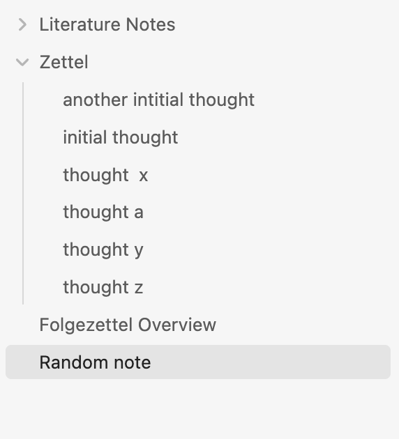

To illustrate, this is my test vault folder structure:
