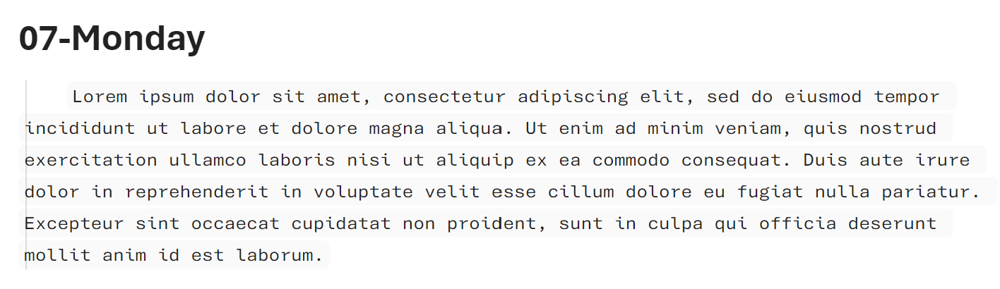

Indented code block looks glitchy in Live preview mode
  1. Copy the following text:
Lorem ipsum dolor sit amet, consectetur adipiscing elit, sed do eiusmod tempor incididunt ut labore et dolore magna aliqua. Ut enim ad minim veniam, quis nostrud exercitation ullamco laboris nisi ut aliquip ex ea commodo consequat. Duis aute irure dolor in reprehenderit in voluptate velit esse cillum dolore eu fugiat nulla pariatur. Excepteur sint occaecat cupidatat non proident, sunt in culpa qui officia deserunt mollit anim id est laborum.
  1. Paste it into a note
  2. Make sure that you’re in live preview mode
  3. Highlight the text and hit tab to make it a code block
Yes

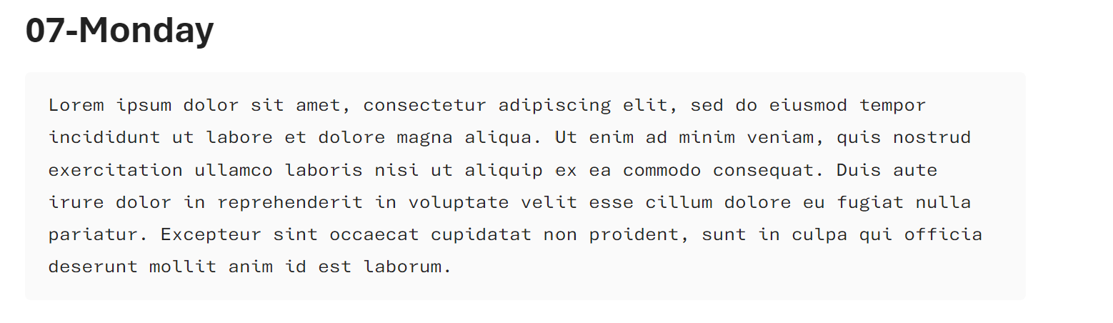

Should appear as a code block like it does in reading mode:

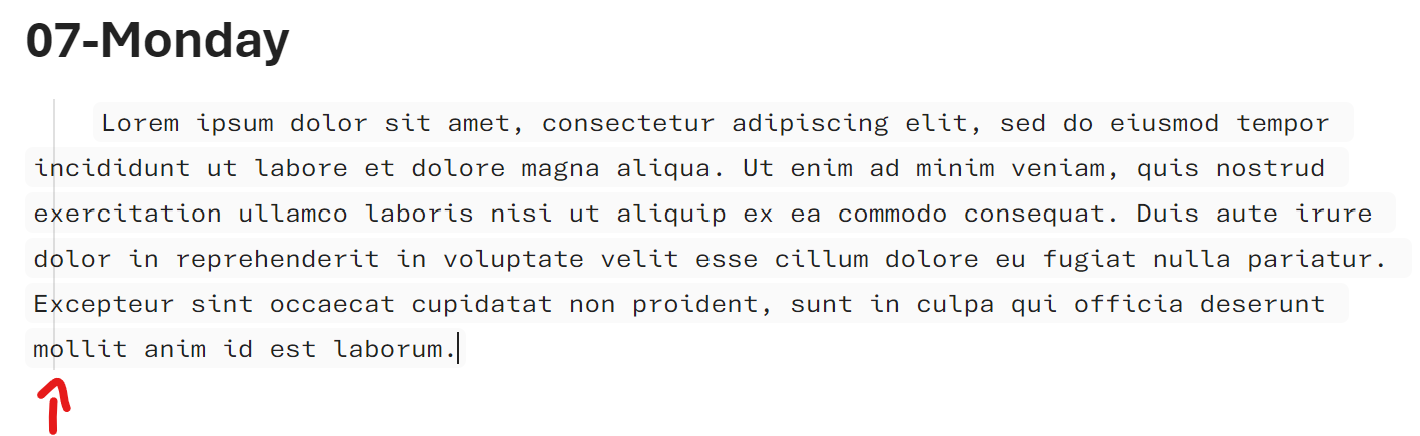

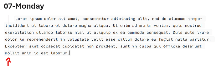

The visual appearance is completely inconsistent with reading mode, and if the text is multiple lines the appearance is very bugged with a vertical line appearing under the text:
NOTE: It looks slightly better in source mode, but still pretty bad with the verticle line being too close to the text:

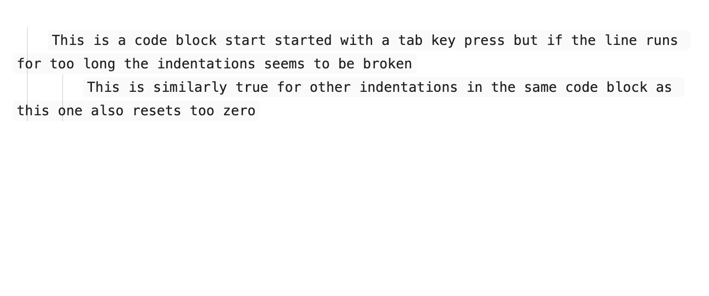

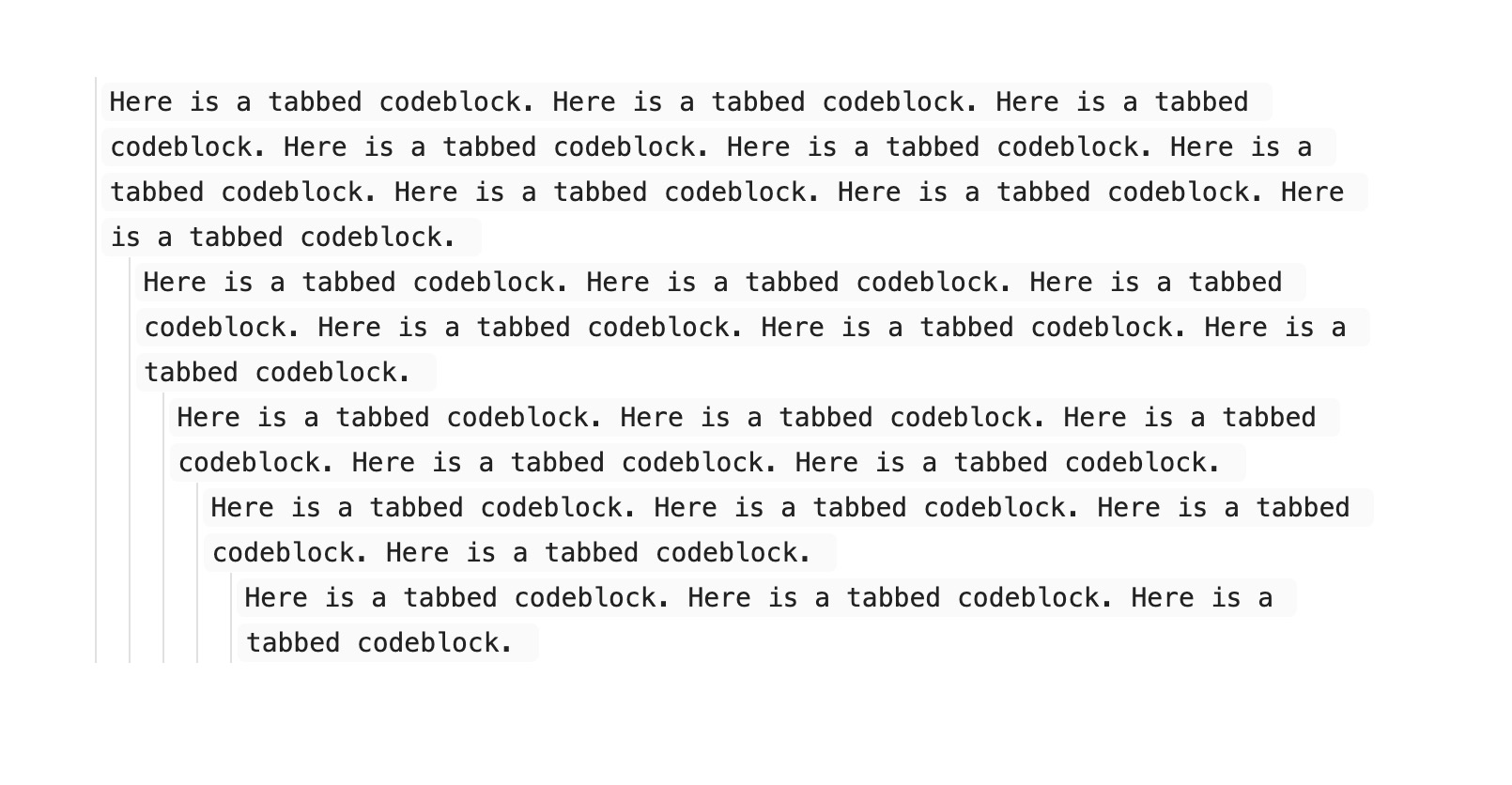

Code block indentation seems to be broken. This is using the default theme, no snippets and no community plugins
  1. Create a new note
  2. Press the tab key for indentation
  3. Write a line long enough that it word wraps
That the line indentation is in line with the code block
The line is resetting to zero on wrap
Latest version on MacOS with latest Obsidian version
similar:
Yes, same. I don’t understand the answer, though?
thanks. It’s not preformatted text. It’s a codeblock
Does that mean it’s expected behavior?

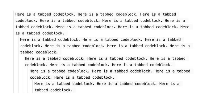

I made a CSS snippet that fixes the indentation for tabbed codeblocks in preview for me. Maybe others experiencing the same issue find it useful.
Play with the values at the top in case you are using a different font or other.
tab indent fix.css (2.5 KB)

For anybody looking for an momentarily solution, the CSS snippet I shared works for me.
Here is it in code, going up to indent level 10:
body {
   --ms-code-tab: 1.8ch;
   --ms-code-nudge: 0ch;
.markdown-source-view.mod-cm6
.cm-line:has(.cm-hmd-indented-code) {
    --ms-wrap-indent: calc(1 * var(--ms-code-tab) + var(--ms-code-nudge));
    padding-inline-start: var(--ms-wrap-indent) !important;
    text-indent: calc(-1 * var(--ms-wrap-indent)) !important;
.cm-line:has(.cm-hmd-indented-code):has(.cm-indent ~ .cm-indent) {
    --ms-wrap-indent: calc(2 * var(--ms-code-tab) + var(--ms-code-nudge));
.cm-line:has(.cm-hmd-indented-code):has(.cm-indent ~ .cm-indent ~ .cm-indent) {
    --ms-wrap-indent: calc(3 * var(--ms-code-tab) + var(--ms-code-nudge));
.cm-line:has(.cm-hmd-indented-code):has(.cm-indent ~ .cm-indent ~ .cm-indent ~ .cm-indent) {
    --ms-wrap-indent: calc(4 * var(--ms-code-tab) + var(--ms-code-nudge));
.cm-line:has(.cm-hmd-indented-code):has(.cm-indent ~ .cm-indent ~ .cm-indent ~ .cm-indent ~ .cm-indent) {
    --ms-wrap-indent: calc(5 * var(--ms-code-tab) + var(--ms-code-nudge));
.cm-line:has(.cm-hmd-indented-code):has(.cm-indent ~ .cm-indent ~ .cm-indent ~ .cm-indent ~ .cm-indent ~ .cm-indent) {
    --ms-wrap-indent: calc(6 * var(--ms-code-tab) + var(--ms-code-nudge));
.cm-line:has(.cm-hmd-indented-code):has(.cm-indent ~ .cm-indent ~ .cm-indent ~ .cm-indent ~ .cm-indent ~ .cm-indent ~ .cm-indent) {
    --ms-wrap-indent: calc(7 * var(--ms-code-tab) + var(--ms-code-nudge));
.cm-line:has(.cm-hmd-indented-code):has(.cm-indent ~ .cm-indent ~ .cm-indent ~ .cm-indent ~ .cm-indent ~ .cm-indent ~ .cm-indent ~ .cm-indent) {
    --ms-wrap-indent: calc(8 * var(--ms-code-tab) + var(--ms-code-nudge));
.cm-line:has(.cm-hmd-indented-code):has(.cm-indent ~ .cm-indent ~ .cm-indent ~ .cm-indent ~ .cm-indent ~ .cm-indent ~ .cm-indent ~ .cm-indent ~ .cm-indent) {
    --ms-wrap-indent: calc(9 * var(--ms-code-tab) + var(--ms-code-nudge));
.cm-line:has(.cm-hmd-indented-code):has(.cm-indent ~ .cm-indent ~ .cm-indent ~ .cm-indent ~ .cm-indent ~ .cm-indent ~ .cm-indent ~ .cm-indent ~ .cm-indent ~ .cm-indent) {
    --ms-wrap-indent: calc(10 * var(--ms-code-tab) + var(--ms-code-nudge));
