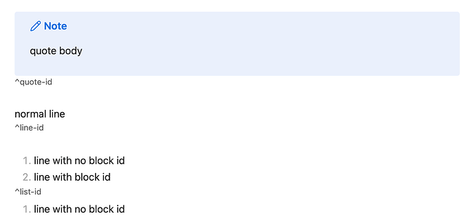

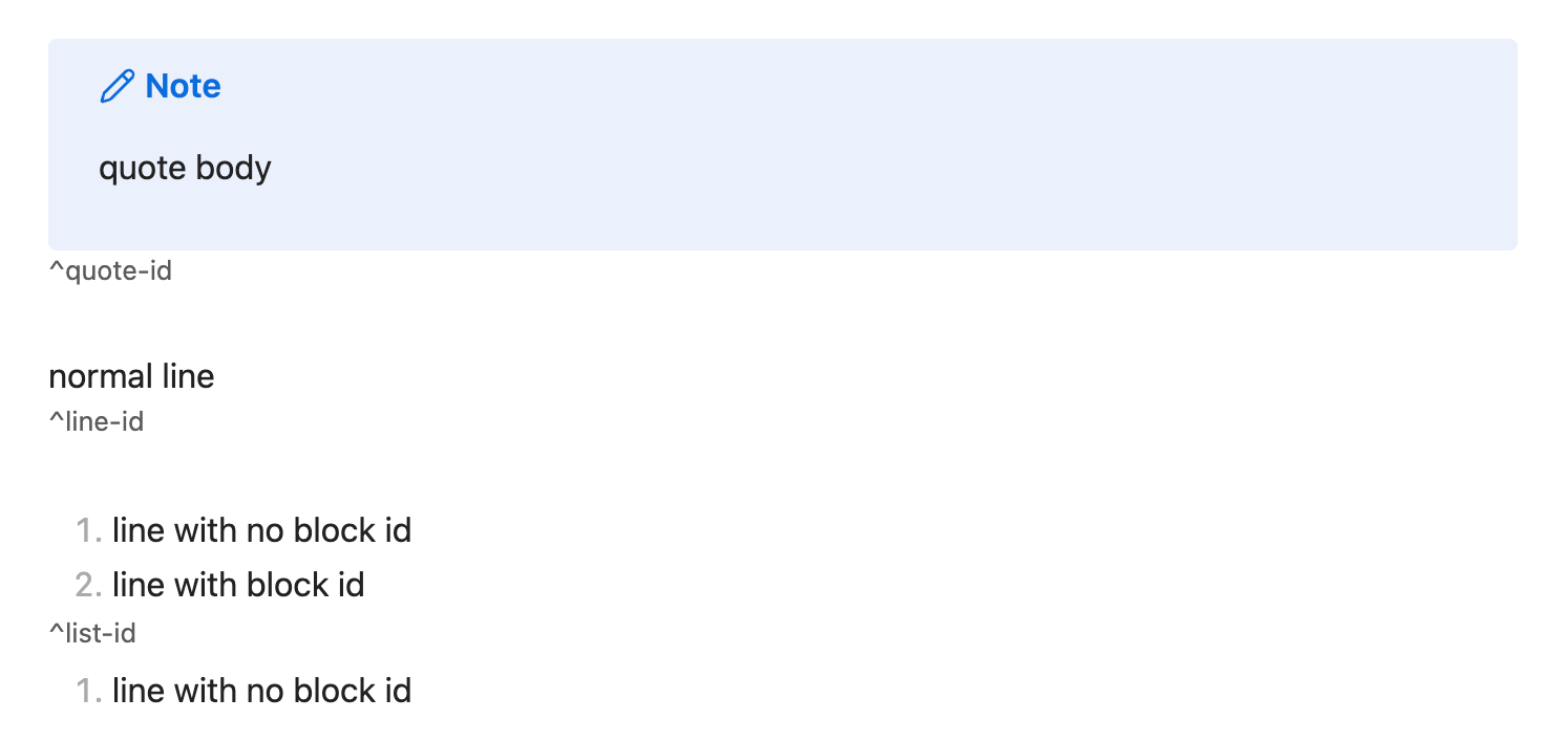

Add the following lines (please remove code syntax):
> [!note]
> quote body
^quote-id
normal line
^line-id
1. line with no block id
2. line with block id
^list-id
Y

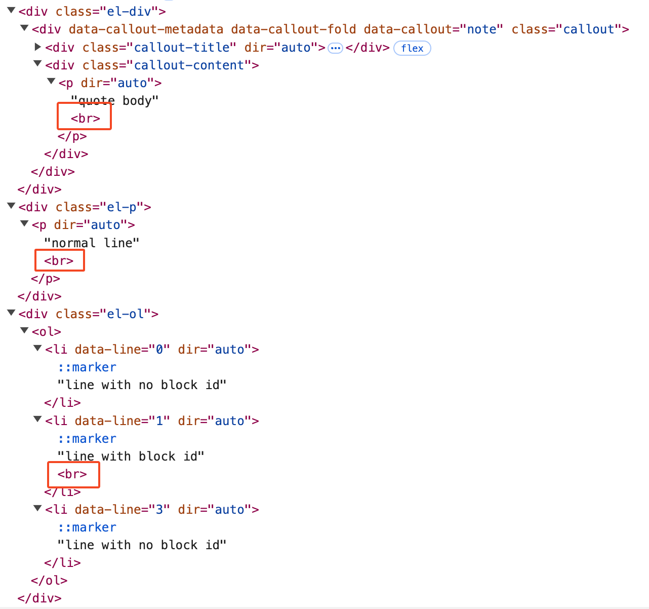

Expect that in reading mode, HTML for line with or without block ID is the same.
Line with a block ID will have a <br> inserted at the end.

Can this <br> tag be removed? I use it to style when list has multiple paragraphs.
