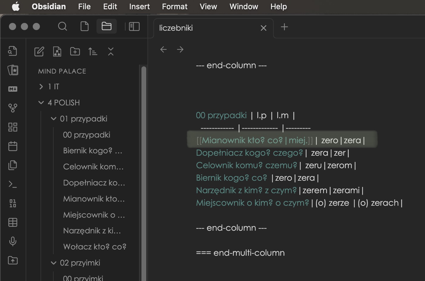

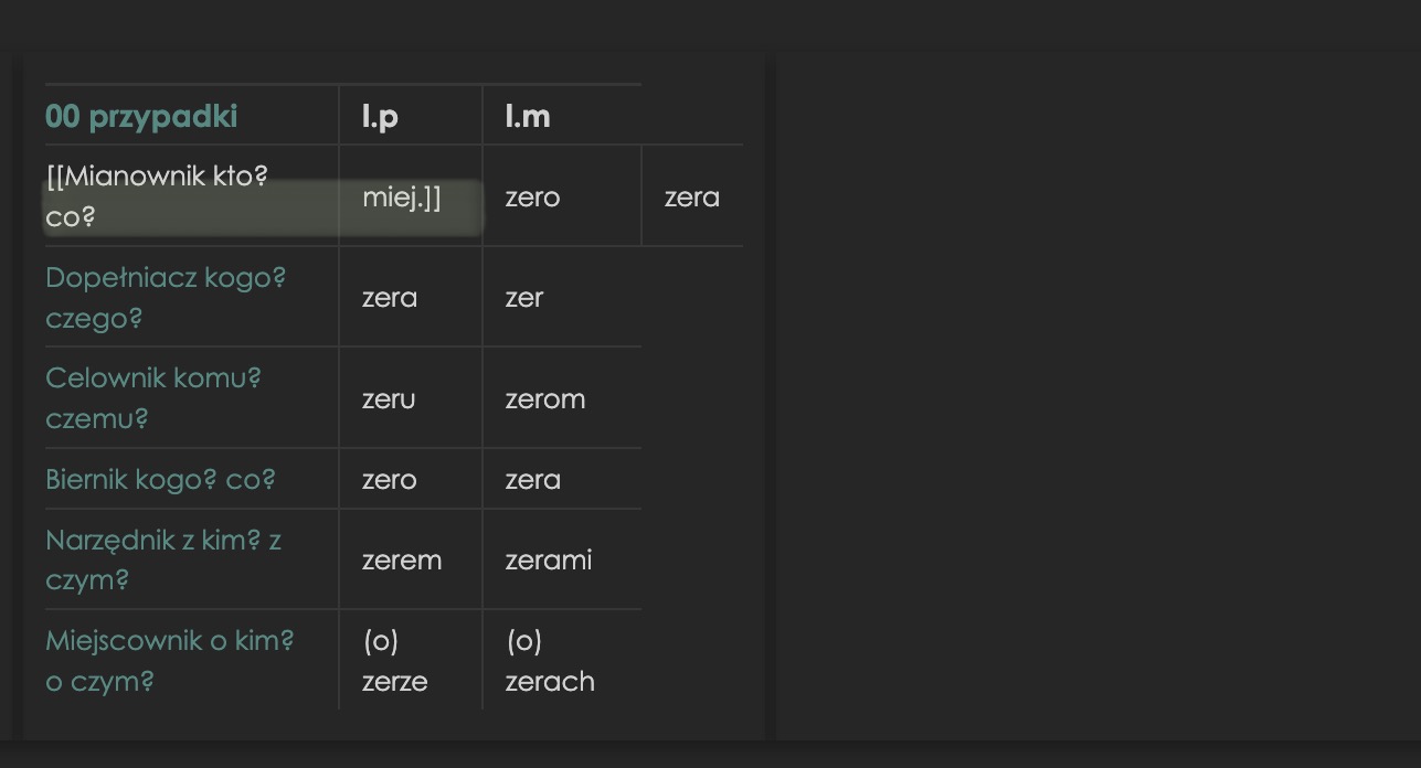

I have a problem with using the sign « | » in links that are inside a table because they affect the formation of the table itself. I hope I wrote clearly. Can it be fixed somehow?

You have to escape the | so it doesn’t get misunderstood as a separator by typing \| instead. So your link needs to look like [[FileName\|Text]].
