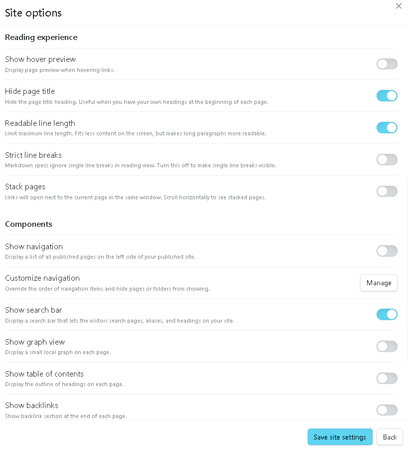

- In publish settings > change site options > Toggle off “Show table of contents”

- Clicking on the internal links in the same note to jump to that specific heading does not work when “Show table of contents” is toggled off.

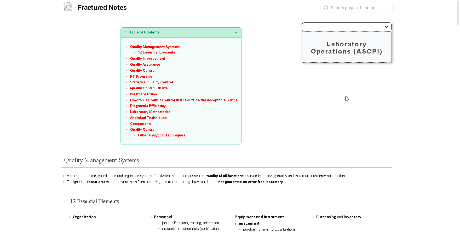

Internal links in same page with “Show table of contents” toggled OFF.

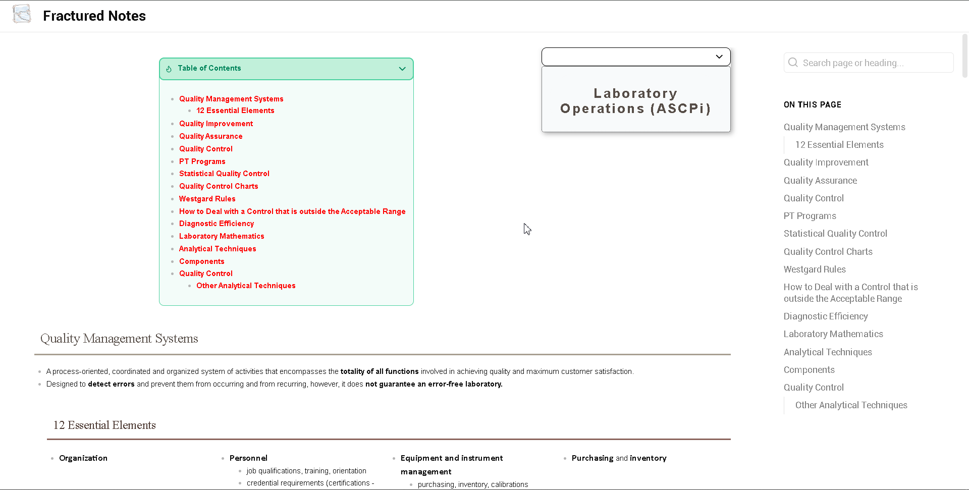

Internal links in same page with “Show table of contents” toggled ON.
