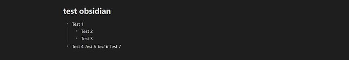

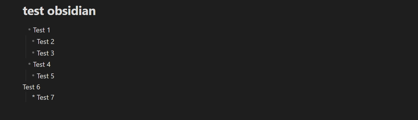

What I mean by softbreak is when pressing Shift+Enter.

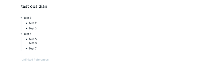

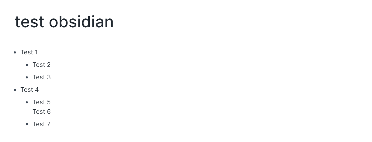

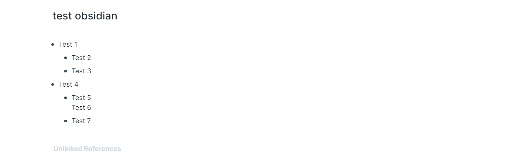

In roam, it returns to the line without creating a new bullet.
When importing to Obsidian, the line break does not respect the indentation.
Please see below the roam page and the import on obsidian, with indentation not respected.

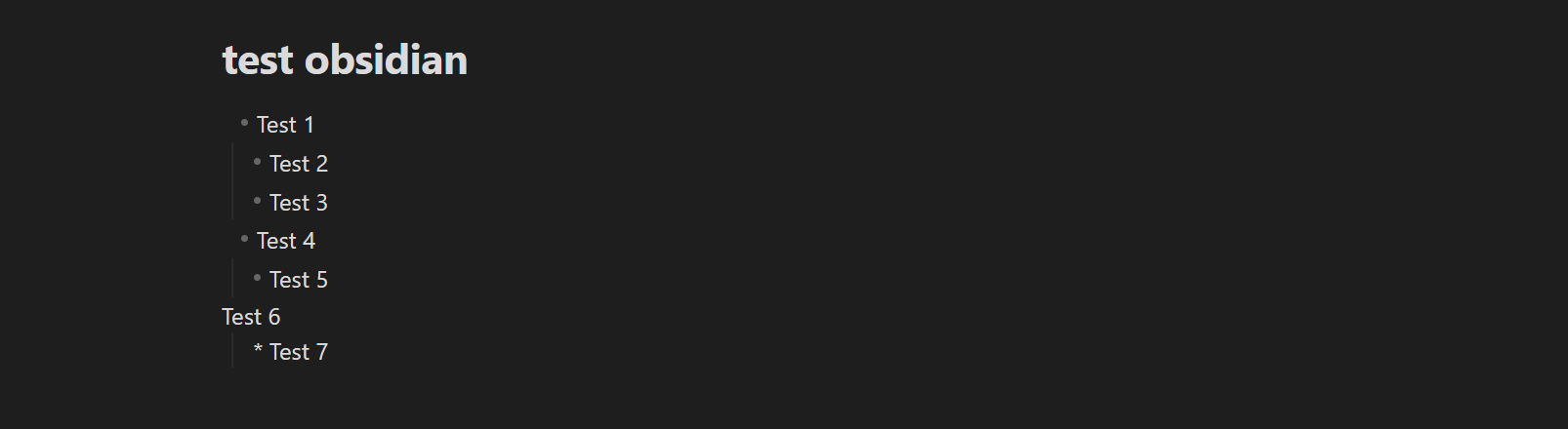

Here is the screenshot of the edit view
The text you pasted in the code block is not the same text shown in any of your screenshots. Did you copy it while in reading view? It needs to be copied from edit view.

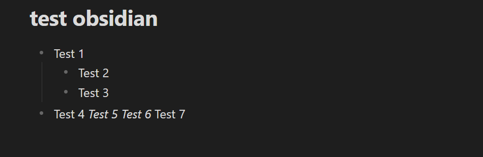

Hi,
Here is the screenshot from edit view:
Here is the screenshot from the reading view:
Here is the screenshot from Roam:
