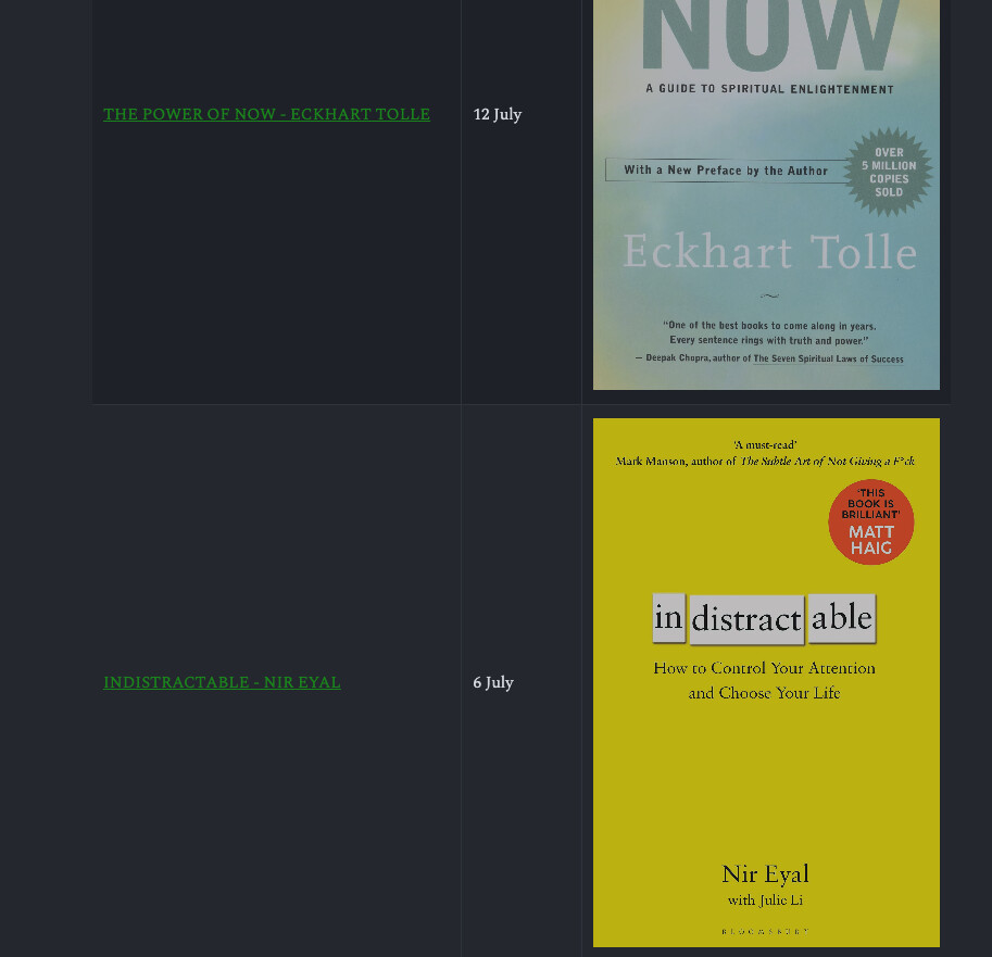

Hi everyone, I’m trying to display the cover of books I’ve read in a dataview table, but images are way too big, as you can see:
How can I achieve a smaller size? In the single notes I’m just typing
Cover::
.Thank’s.

Hello, it does resize on the note but not on data view cells.
Hmm… How does the query look to generate those image currently?
Is it an option to use embed() to have a better presentation of the images?
Inside the note I type Cover::
and inside dataview I just add “Cover as Cover”.

It does not work either way. I think there must be a simpler solution, for example look at this.
The article propose to use:
table Author, ("") as Cover
But it does not work to me, as you can see:
Are you able to do this with an image of your own, and get the varying sizes?
If so, there is something with how you defined the Cover
inline field, in your case. Or possibly with some plugins, but in order to track this down, if you really care to do so, we need to eliminate the various stuff which can go wrong.
I solved.
Problem was that I was using Cover:: ![]… inside a single note thus dataview took the whole text. Solution was to just type “Cover: url” in the frontmatter.
