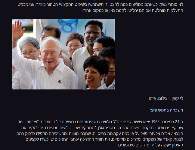

Hi Obsidian team!
Here to report a small but noticable bug when using Obsidian in right-to-left languages, which are now officially supported from my understanding.
  • Write a text in a right to left language and insert an image in the middle
If you put images in the middle of such a text, the images will appear as if the text is left-to-right, which looks weird when you read through it. Attaching a few examples

Yes, the result was similar
The image appears either centered or attached to the right, same as the text.
The image appears on the left, as if the note is in English

Is obsidian globally configured to work in right-to-left or left-to-right mode?
Globally left to right, but I use English for the majority of my notes so I’d like to keep it that way. Is it possible to set it on specific notes?
Ok, so I don’t think there’s a bug here.
You can use LTR/RTL mark characters to force the line of the image to be on specific side.
There’s also this FR and the Obsidian RTL third party plugin that implements some more functionality.
Got it, thanks!
