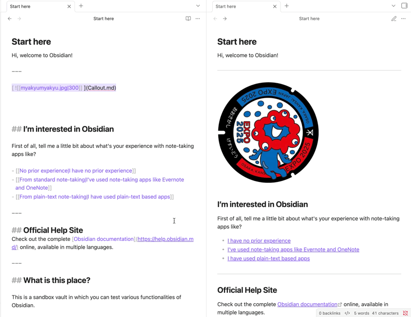

I am trying to designate an image as a link to a document in my vault. I have tried the method most commonly suggested in other forum advice, but it simply doesn’t work.
I’ve been using the format:
2026-04-25 09_13_42-Top topics - Obsidian Forum — Mozilla Firefox
The result is that the first set of square brackets and everything outside are deprecated to normal text, while the image appears.
Hope someone out there has had this struggle before and found a solution.
Something like [ ![[image.jpg|300]] ](note.md) will only work in Reading view (not in Live preview). Could that be the issue?
source mode | reading view
CleanShot 2026-04-25 at 08.30.07
^ here I’m clicking on the image in reading view
Thanks so much. Got it in one; I hadn’t even though to check that. Much appreciated
