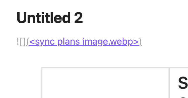

The markdown link should be represented using the form:
[](<Path To File With Spaces>)
The angle brackets are used to escape a filename containing spaces by all markdown implementations respecting the common mark standard (can provide a link).

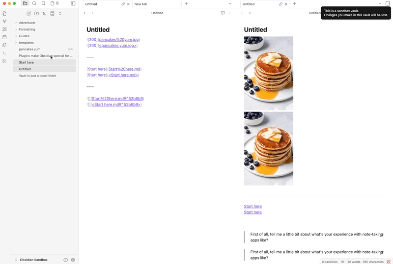

By default, the spaces are encoded as%20 in markdown links when you drag a file into a note. Is that not happening for you?
You can manually type and use <>, but Obsidian doesn’t add those in itself.
Encoding them this way in this particular context doesn’t seem to be compliant with how Markdown is being used elsewhere. See example 485 in the latest commonmark spec.
URL encoded links (opposed to the bracketed ones) have been the type Obsidian creates from when I started using Obsidian.
Looks like there’s a FR here for an option:
I know the auto-updating of bracketed links was broken for a while:
^The second topic here looks like it may have been implemented/fixed (for the “shortest path when possible” setting, at least).

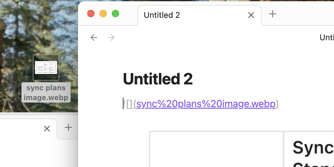

CleanShot 2025-11-25 at 17.04.30
When I drag and drop I get the version with %20, which is valid, not this.
