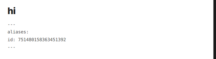

  1. Create a new note
  2. Add an ‘id’ property field

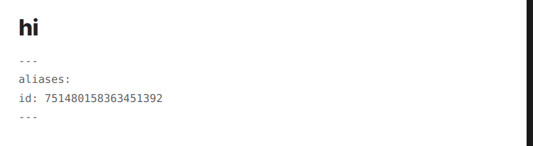

  3. Enter source mode
  4. Enter the value 751480158363451392
  5. Switch out of source mode
Yes.

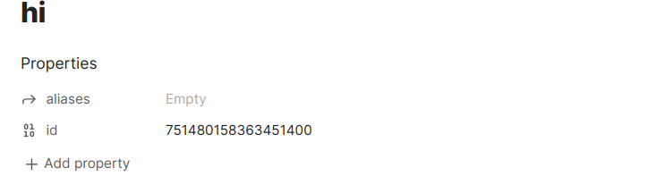

I expect to see the same value (ending in 392)
I see the last 3 digits change to 400.
Running on Linux right now but also verified on iOS.
Obsidian version: v1.8.4
Installer version: v1.7.7
Operating system: #49-Ubuntu SMP PREEMPT_DYNAMIC Mon Nov 4 02:06:24 UTC 2024 6.8.0-49-generic
Catalyst license: none

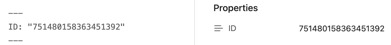

Weird. Seems to work if stored as Text rather than Number:
Is this something you are doing, or is this a built-in property that Obsidian is generating via some command or convention? I assume this is your own property, and you’ve set it to type “Number”, correct?
I think you’re just reaching the maximum length of an integer in (Javascript I assume?) Obsidian. And so it’s rounding it off. It’s likely storing it in a bit-depth that you are exceeding.
It makes sense that storing it as a string would allow you to have any arbitrary length. If this is your own convention for storing unique ID numbers, I suggest you use strings. Unless you have a reason to compare the numerical value (greater than or less than, etc.)
Also, I don’t believe this has anything to do with Source Mode. You’ll see the same result if you reload or restart Obsidian. Or close and reopen the note.
Testing this out further. I looked up the biggest int in Javascript Number.MAX_SAFE_INTEGER - JavaScript | MDN
9007199254740991
And yes if I enter 9007199254740992 it works. If I enter 9007199254740993 it rounds back down to 9007199254740992
So I’m going to move this from bugs. This isn’t a bug. You’ve just a hit a limitation of integers in Javascript, and will have to work around it with fewer digits, or strings.
