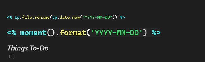

I have installed a GTD-solution, which uses Templater to work smarter.
The first few times I use the system, everything is fine, but suddenly (after a day or two), I don’t see the smart output (eg current date), but the source code instead
  • source: I see a lot of description on how to enable “view source” - I want to go the opposite way, but removing the check-mark doesn’t help me.
  • Templater: I get too many Q&A on installing, configuring, …
  • I have enabled and disabled “View Source”
  • I have changed directories in the Templater-settings,
  • I have toggled a lot of other settings in Templater
  • I have removed Templater pluginn and reinstalled
What I see
I expect the scripts to be solved, and display the output, but in stead I get a “source-look”.
Attached
  • Daily3.md : My template for Daily Note
  • WhatISee.png: This is what I see when I look at my new note

From what I see in your screenshot, this isn’t “source”…
It just looks like the template is just not run through templater which therefore can’t output anything …
Now I have no idea what you mean by:
… or how you installed the said GTD-solution but a question would be: How do you create your daily note ?
… and in Templater’s settings do you have the setting: Trigger Templater on new file creation toggled On?
THANKS!!!
“Trigger Templater on new file creation” was off. That solved my problem!
Thanks again.

iirc, that Templater settings is off by default and it’s one of the most common reason why a template doesn’t get applied when it should :blush:
(An another one, is running a Templater’s template through the Templates Core plugin instead of Templater)
I asked about the GTD method because in Obsidian’s environment, it could have been tied to another plugin than Templater, or a premade vault you found somewhere… which could have played a role in your issue :blush:
