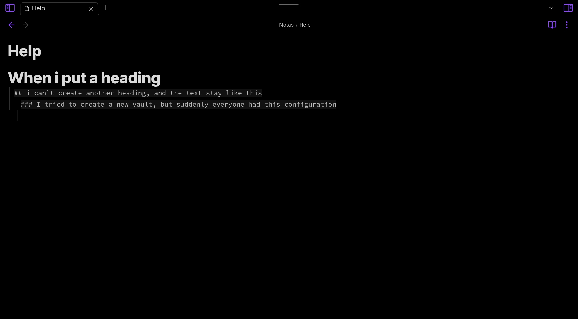

my obsidian was normal, out of nowhere it is not putting more texts inside the heading. I’ve even tried to create a vault from scratch, but still with the same error! Someone help me
edit mode:
view mode:

I think that you’re just unnecessarily indenting headings. Put the hashes (#) as the first characters of the line and it will be fine.
The following markdown text
# When i put a heading
## I can't create another heading, and the text stay like this
### I tried to create a new vault, but suddelny everyone had this configuracion
is rendered as you expect:
BUT, if you add indentation (tabs or spaces before the hashes), they are rendered as a codeblock.
Notice the vertical lines that appear on the left while editing. They show the indentation level for each line:

The reason your first example works is because it’s part of a list.
As andrezgz said, if you have 4 or more spaces outside of a list, it will turn into a code block.
See Basic Syntax | Markdown Guide
