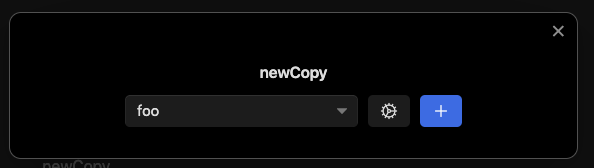

You’ll now get a new line (with your new choice) at the end of the list above the line with the button. First of all hit the lightning symbol on right side, and then hit the cog wheel right next to it. You’ll now get this dialog window:
It’ll show something unrelated, so hit the + button, and it’ll change to “newCopy”, and you can then hit the cog wheel to the left of the + button. Which opens the following dialog window:
Click in the User script box, and you’ll get a drop down where you should be able to locate the newCopy.js script from above. Note that the folder it’s placed in is irrelevant, as long as it is somewhere within your vault. (You can also start typing “newCopy” to find this script). When found/selected, hit the Add button to the right of this script, and close the dialog window, and the previous dialog window.
