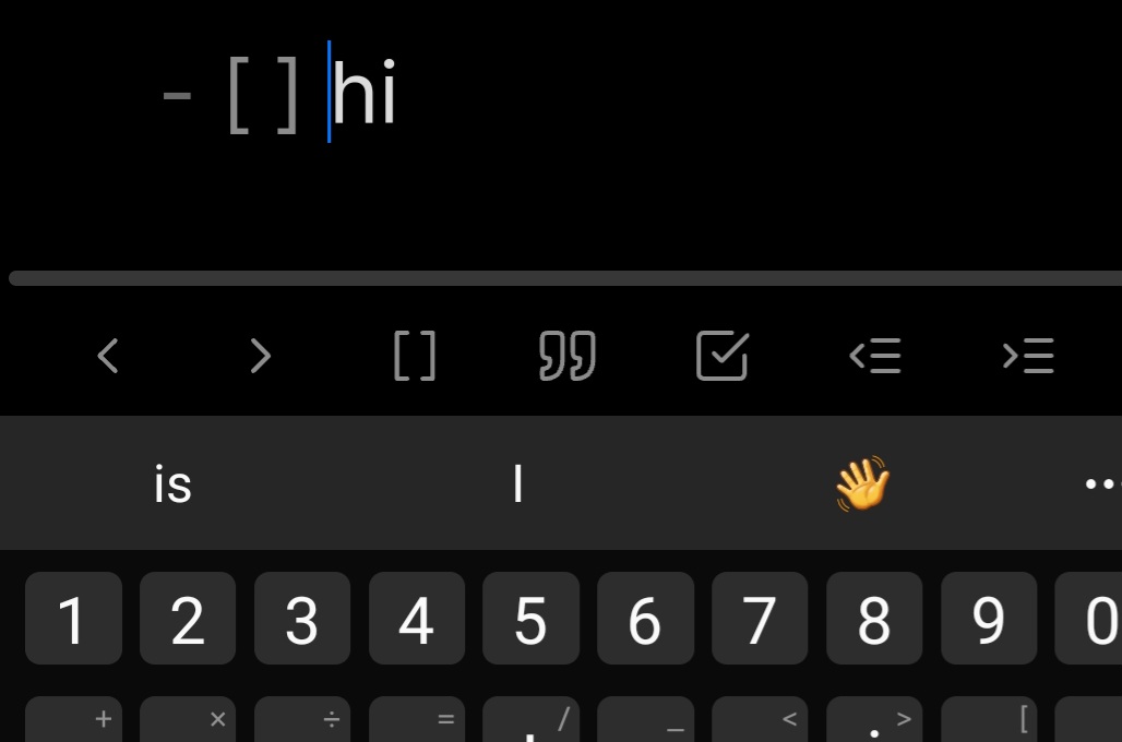

I’ve had the same kind of issue with precise placement of the cursor on mobile devices, but I found a setup of the toolbar which made it a lot easier.
Here you see the cursor is before “Hi”, but now I can hit the leftmost < to move it left. In other words, use my finger to place it close to where I want it, and use the toolbar for better placement.
To configure the toolbar go to settings > mobile. My current setup is:
