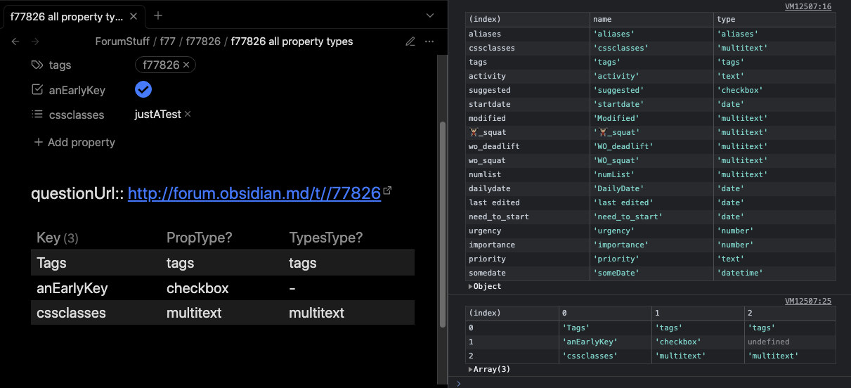

  • However, the most important flaw I found was that the app.metadataTypeManager.types doesn’t list all types of all properties. In fact, I’m not sure what it lists. Possibly it lists only those which you’ve explicitly set in the property editor, or which has a predefined value by Obsidian. To get to see the type of all properties you need to access the .properties section of this cache
  • Bonus tip: Some times I enjoy doing a console.table( ... ) to debug larger structures. It presents its variable in a table form readily available with sorting options, and possibilities to change the width of the columns. Can be really nifty every now and then
So here is a revised script doing almost the same, but accounting for some of the properties being found in either section of app.metadataTypeManager:

The output from both reading mode and the console display:
