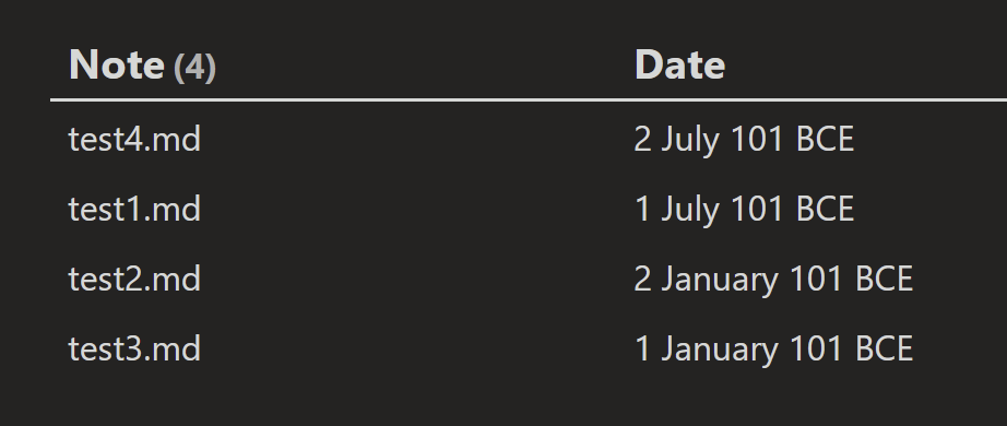

Amazing! I tried it out and in my vault and it almost works, although it doesn’t seem to correctly sort dates within the same year for both BCE and CE years. For instance, it sorts the following 4 dates in this order:
  • 1 July 101 BCE
  • 1 January 101 BCE
  • 2 July 101 BCE
  • 2 January 101 BCE

After your edit, within-year sorting works perfectly on my end! However, it doesn’t sort across years correctly for BCE dates, e.g. it gives the following sort order:
  • 1 January 101 BC
  • 2 January 101 BC
  • 1 December 101 BC
  • 1 July 201 BC
where of course 201 BC should be before 101 BC.

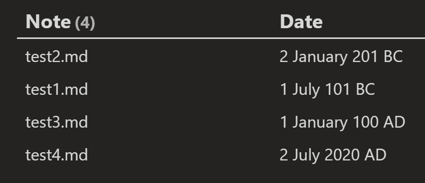

Works like a charm! Thanks so much!
For posterity, here’s the full code block as I have it:
```dataviewjs
dv.table(['Note','Date'],
  dv.pages()
    .where(page => page.date_test)
    .array()
    .sort((b, a) => moment(a.date_test, 'YYYYYY-MM-DD').format('x') - moment(b.date_test, 'YYYYYY-MM-DD').format('x'))
    .map(page =>
        page.file.path,
        moment(page.date_test, 'YYYYYY-MM-DD').format('D MMMM y NN')
