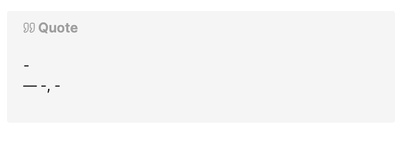

  1. How can I verify that I am using the right quotation marks? I copy those quotes, quotation marks come with it automatically and they do look fancier than my regular ones on a desktop, but I can’t tell the difference on a phone… Tried retyping it, still doesn’t show the quote when there is “:” inside a text.
  2. Obsidian Version: 1.5.3 (Installer 1.4. 16); Dataview: 0.5.64 (BTW, any way to set it to update automatically?!)
  3. How it breaks? It just doesn’t show anything instead of the “this.quote-text”. Here is an example how it looks when it works:
    works
Here is an example when it doesn’t work:
does not work
Thank you so much!!!
