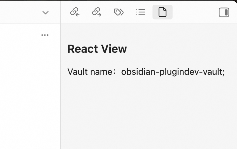

I can create a view in right side bar:

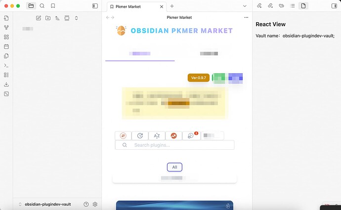

but how to implment a react view in main editor area like this?
You just need to “open in the middle”:

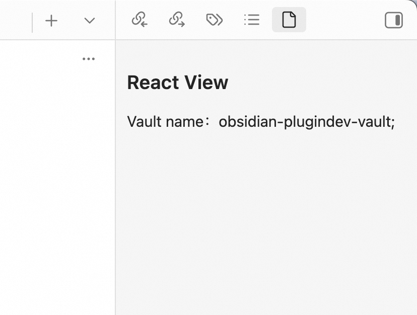

Hi, thanks your reply. I follow your code, but still not work:
please check it.
Hi, thanks your reply. I follow your code, but still not work. please check it:

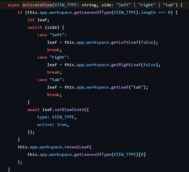

I noticed your code uses this.activateView(VIEW_TYPE_EXAMPLE, "left");
Have you tried this.activateView(VIEW_TYPE_EXAMPLE, "tab");?
I tried, but the view still in “right”.
