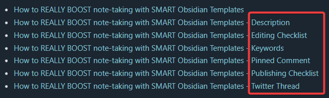

I tried - and failed. My current dataview code:
LIST FROM "01 👻 Projects/🎞️ LP Videos"
WHERE contains(file.name, ("<% tp.file.title.split(' - ')[0] %>"))
	AND file.name != "<% tp.file.title %>"
SORT file.name ASC
resulting in
and i would like to have only the part of the note title inside the red rectangle.

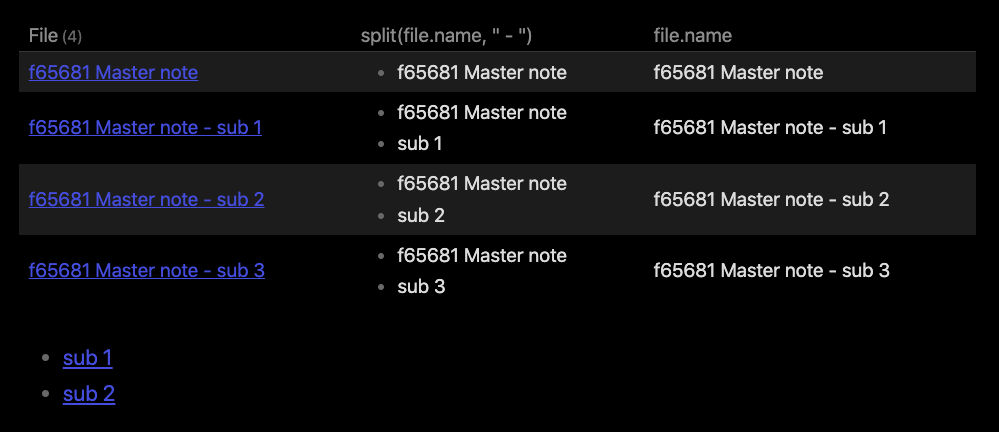

I’m kind of surprised why your split is not working, as it does work in my case. So here are two queries two further explore your case:
```dataview
TABLE split(file.name, " - "), file.name
WHERE startswith(file.name, this.file.name)
```dataview
LIST WITHOUT ID link(file.link, split(file.name, " - ")[1])
  AND contains(this.file.outlinks, file.link)
In my simple test setup with three sub notes, where only the two first are linked from the master note, this results in the following output:
