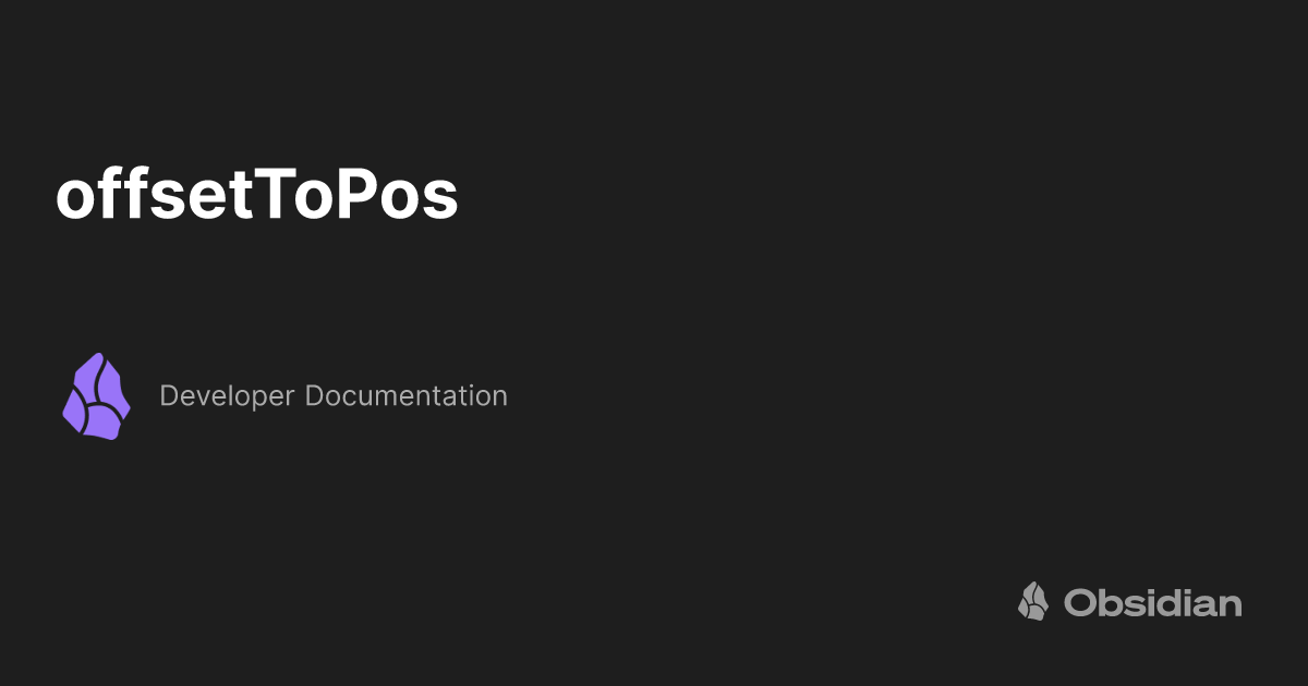

Assuming you can get a proper position info from posAtDOM, you can use this method to convert that position into EditorPosition.
But Obsidian API’s Editor interface is just a wrapper for CodeMirror, so you can also edit the document directly with CodeMirror. (But CodeMirror takes some time to learn)
